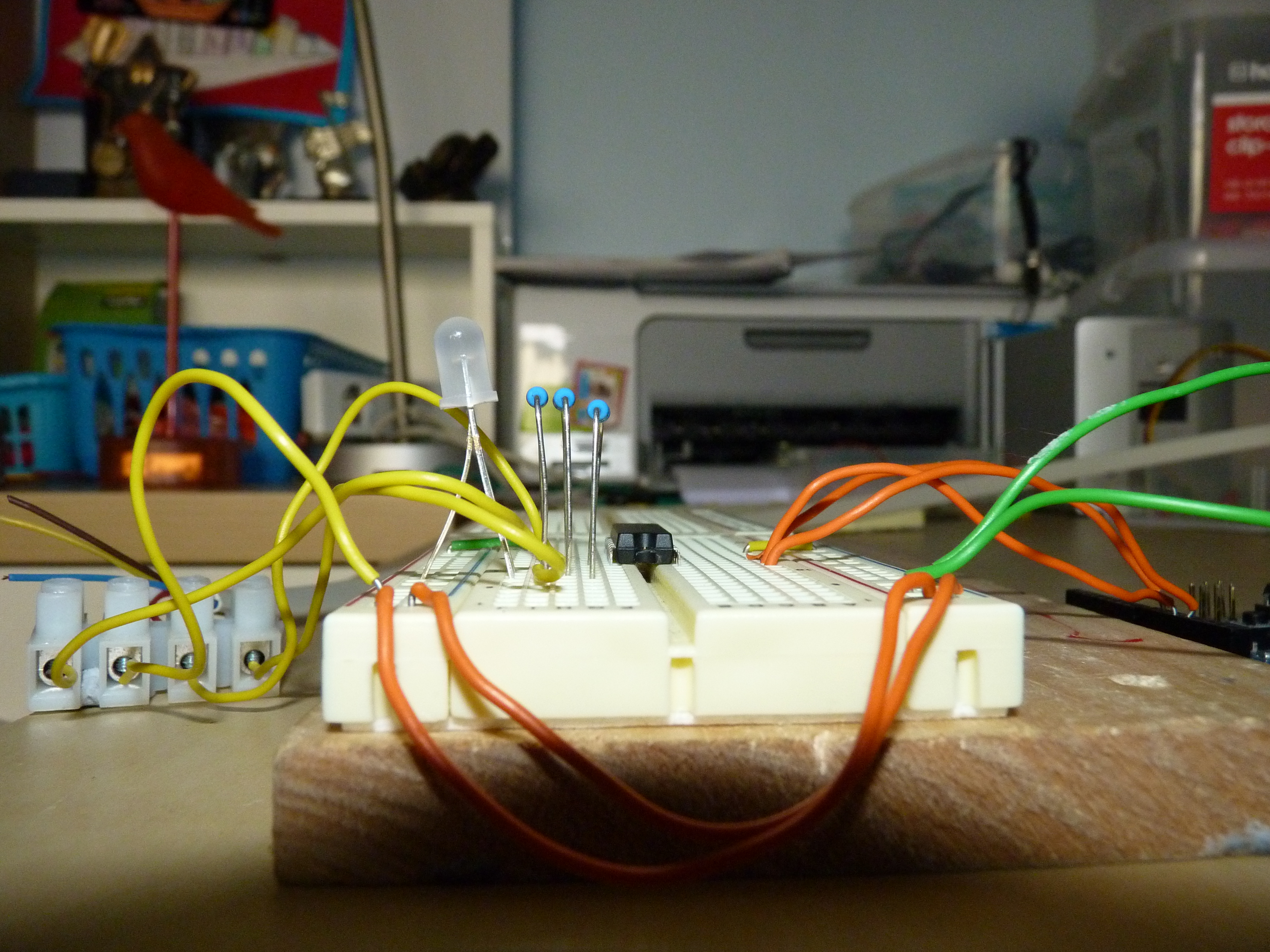

Step 2: Setup
this is how you setup your led for common cathode of you have the other type go to step 3
red pin to resistor to pin 9
green pin to resistor to pin 10
blue pin to resitor to pin 11
longest pin to ground
DI is blue pin
D2 is green pin
D3 is red pin
