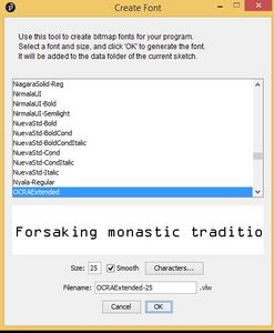

Before using this IDE, we have to configure the font.
For this, we have to install “OCRAEXT.TTF” file which is located in Radar.zip .

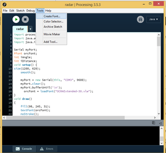

Then, go to tools/create Font. Select “OCRAExtended” from the list, choose font size 25 and click OK.
Step 8:
Now, we have to find the COM Port number. Go to Arduino IDE and find the Com port(COM3 in photo). Put the COM port number in line 13 of processing code (COM3 in photo).
