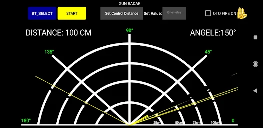

Mobile Application and Control Panel
The app offers the user the following control options:
Bluetooth Connection: Press the “BT_SELECT” key to communicate with the radar unit.
System RUN/STOP: Activate the system with the “START” button.
Target Distance Setting: Enter the distance value with “Set Control Distance”.
Auto Fire Mode: Activate by checking the “AUTO FIRE ON” box.
Bullet Control: The system can be activated if there is a bullet.
