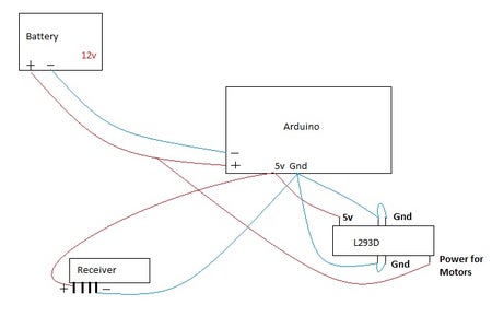

* Place arduino on the car also and batteries and breadboard with L293D and Receiver
Step 3:
Connect arduino with L293D and receiver and connect the power
On the picture are only few connections ...
