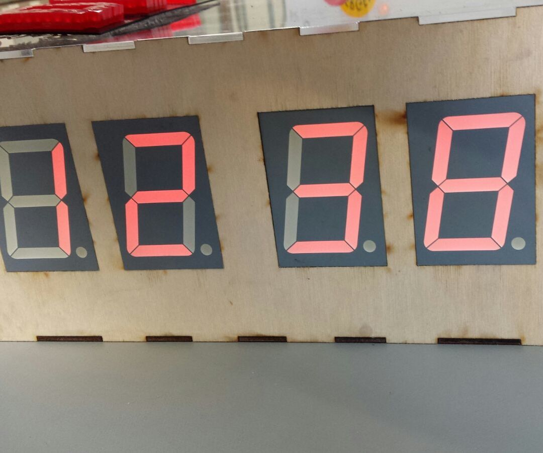

I saw some RTC projects on the internet, but none of them were shown with 7-segment Displays.
This instructables is about my version of the RTC shown with 7-segment Displays.
I am using a RTC DS1307, to keep the correct time, to show this time I am using four large 7-segment Displays and an Arduino Uno with four 8-bit shiftregisters.
This project is concealed in a box, which displays are cut to size from the box and the back and top of this box are made out of plexiglass, so you can watch it from the inside.

Step 6: Case
I made my case with some help from makercase.com
I really want to show the inside of my project, but I wanted it to look good too. That is why I chose to make the back and top out of plexiglass and the rest out of wood.
These two files are the files I used for laser cutting the box.
