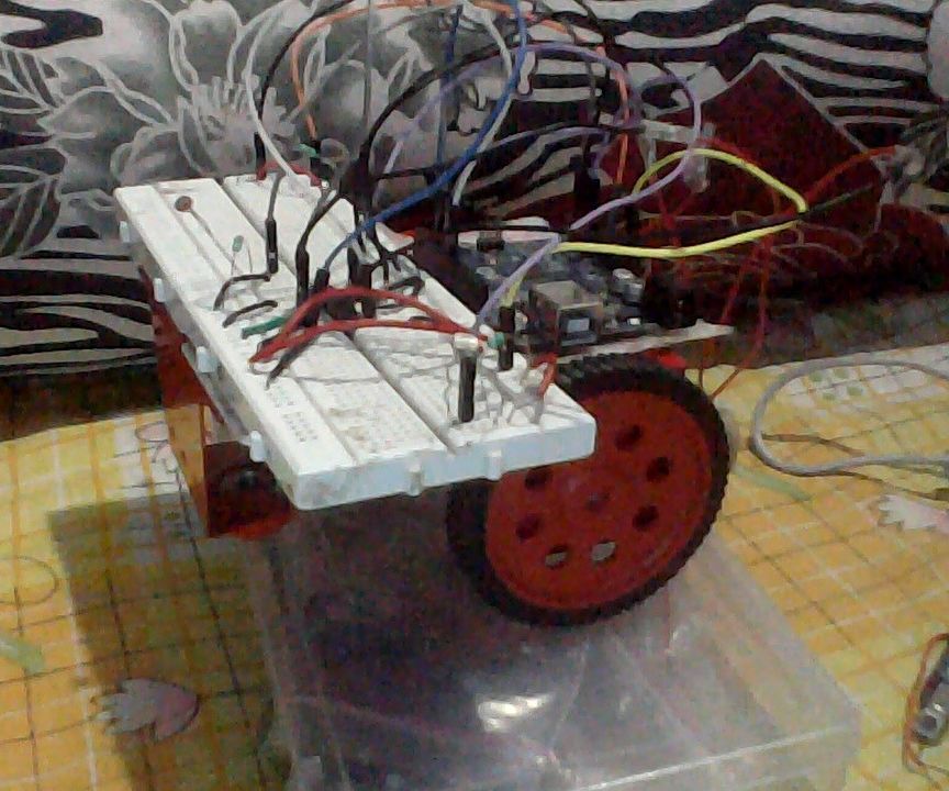

Step 2: Making the Vehicle
Assemble the motors,wheels and castor wheels on the Robotic Chassis.
Use two sided tape to attach a mini/regular Breadboard on the Chassis.
Use a Screw to attach the Arduino at your desired location. Make sure the down side of the Arduino is insulated using a cardboard or other usable materials.
Step 3: Connecting Ground and +5v
Connect A jumper wire between +5v of Arduino to the lowest Channel of the Breadboard.(yellow)
Connect A jumper wire between gnd of Arduino to the upper Channel of the Breadboard. (orange)

Step 7: Checking and Calibrating
Connect your Board to your PC and upload the code below.
The bot should move in the forward direction.
If it moves in a different direction interchange the pin no. of motor pins or interchange the HIGH and LOW of digital outputs.
