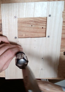

Step 5: LCD Faceplate Mounting
Next we will prepare the LCD faceplate to be mounted onto the front book cover.
- Remove the front cover from the book box by unscrewing the hinges.
- Cut a hole for the LCD faceplate using the dimensions shown above
- Align the faceplate in the hole using the dimensions shown above
- Mark and drill 4 3mm holes in each of the 4 corners
- Using a 6mm drill bit, manually enlarge each hole on the back of the book cover
- With the 4 M3 x 16 screws, super glue all 4 nuts into each enlarged hole
- Remove the 4 screws after the glue dries
- With the 4 M3 x 4 screws, mount the LCD onto the back of the LCD faceplate
- With the 4 M2 x 4 screws, mount the button tray onto the back of the LCD faceplate
The LCD faceplate is now ready to be mounted, but we'll actually mount it in a later step.
Step 6: Mainboard Mounting
We'll now prepare for the mainboard to be mounted on the 4 M3 Nylon standoffs.
- On the back of the front book cover, place the mainboard that you ordered in step 1 at the location shown using the dimensions above
- Mark and drill 4 2.5 mm holes in each of the 4 corners
- Screw and remove a metal M3 screw into each of the 4 holes to tap the hole with threads
- Screw the 4 M3 nylon standoffs into each of the 4 holes
The mainboard is now ready to be mounted, but we'll actually mount it in a later step.

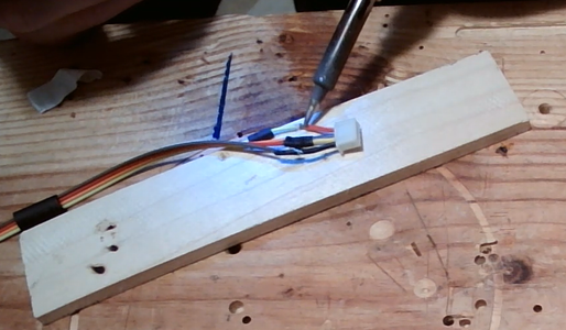

Step 9: Solder Connecting Wires
We'll now solder the connecting wires onto the servo (3 pins) and LCD (4 pins) so that we can connect them to the mainboard. Mount the LCD faceplate, servo lock, and mainboard onto the front book cover so that you can determine the proper wire lengths.
When soldering the wires to the connectors, it's important that the ground pin connects to the ground wire for each component. You can recognize the ground pin on the mainboard as having a square soldering pad (instead of oval). In the pictures above, the ground wires for both the servo and the LCD are brown.
After soldering each wire, be sure to wrap it in electrical tape or (optionally) you can use these heat shrink tubes for a more professional look. ( https://www.amazon.com/gp/product/B01LLBVFGO )
Note: the PCB in the pictures is slightly different than the one in the Gerber file - the 3-pin servo connection has been rotated so that you can plug in from the left of the board, rather than the top.

- Solder the red wire from the battery holder onto one of the leads of the switch
- Install all of the components (LCD faceplate, servo lock, and mainboard) to the book cover lid
- Reattach the hinges to the book cover lid and then attach the book cover lid to the book box
- Solder the 2-pin wire to the battery holder and switch as indicated above
- The black wire to the battery holder black wire, and the red wire to the other lead of the switch
- Connect the DC3-10 pin cable between the LCD and mainboard, folding over the excess cable and securing with a couple of twist ties
- Connect the 4-pin cable between the LCD and the main board, making sure to orient the ground wire properly (refer to the brown wire in the picture above)
