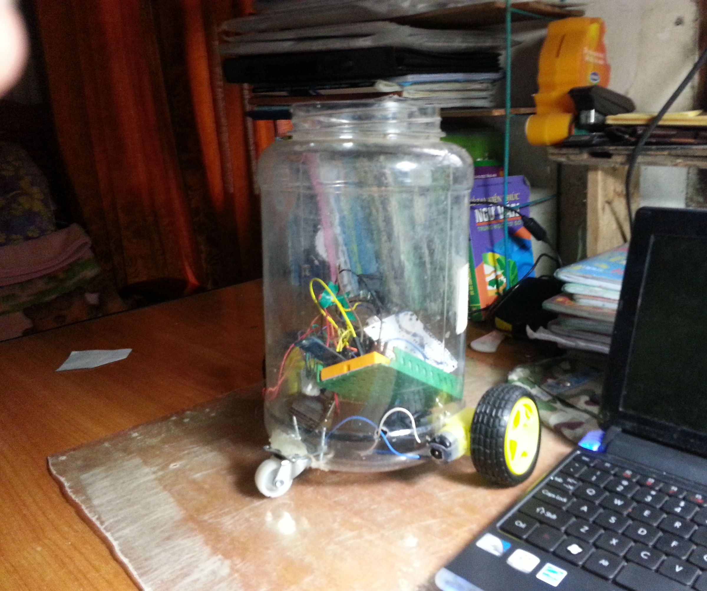

first of all, i am sorry if i have grammar mistakes, i am asian and i am 13 years old, i study arduino by my self (mostly my self) and this is my first project and also my first instructables. this is the robot that i used to compete with my friends in soccer robot. i did some modifications when i used it but it is broken now, so what i show you here is just a smartphone control robot. i will upload the improved, actual soccer robot soon. Thank you to Phan Hoang Anh- my tutor, he helped me alot with the code

-robot platform(picture 6)

put every thing on a platform, put on the motor and the wheels like this and you're ready
