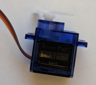

Servos-
  • Servo 1: Shovel at the front of the robot
  • Servo 2: Waving a fitted piece around at the back of the robot

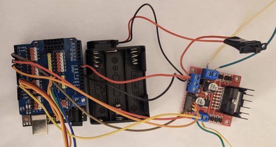

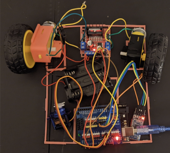

Step 1: Wiring- Arduino Sensor Shield
Align the Sensor Shield onto the Arduino Uno.

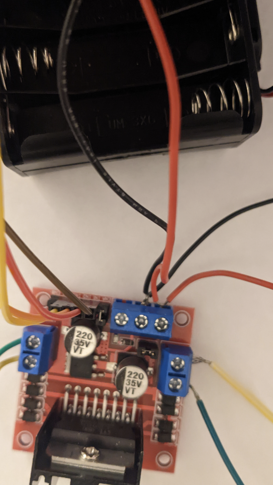

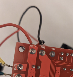

Step 2: Wiring- Connecting the Power Switch
Attach the Battery Pack Brackets to the Battery Pack.
Use the wires of the Battery Pack Brackets to connect the power switch to the Motor Controller. Additional wires can be used to extend their length either through twisting the wires together or through soldering. Soldering can be used to strengthen the connection of the wires if needed.

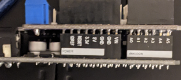

Step 3: Wiring- Connecting It to the Arduino Sensor Shield
Connect the wires to the correct terminals on the Arduino Sensor Shield.
Red wire- Vin terminal
Black wire- GND terminal

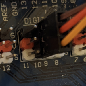

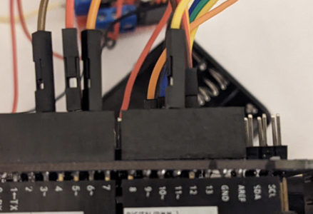

Step 4: Wiring- Arduino Sensor Shield
Use 4 wires and connect them to the 4 pins on the motor controller. Then connect them to the white terminal pin on the Arduino Sensor Shield on pins 3, 5, 6, 11.

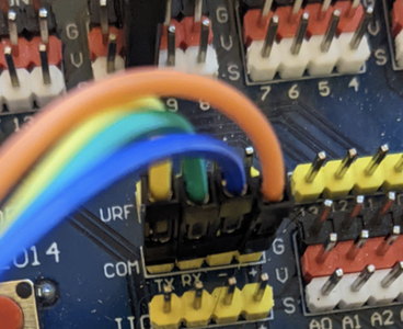

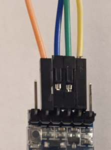

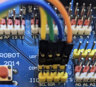

Step 5: Wiring- Connecting Bluetooth
Use 4 Bluetooth wires and connect them to the COM terminals on the Arduino Sensor Shield.
Note: Notice the order of the wires
These wires can later be connected to the Bluetooth Clip when your robot is functioning.

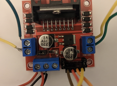

Step 6: Wiring- Motors
Connect the motor wires of the 2 Motors to their respective screw terminals on the Motor Controller. Use a screwdriver to set them in place.
If the wheels spin the opposite direction, flip the terminals of the wires.

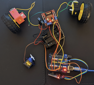

Step 7: Wiring- Servos
Connect the Servo wires onto the specified spots.
Step 8: Additional- Testing
Refer to the Testing Process.
Testing is used to ensure that the wired components are all functioning properly.
If working properly, the Bluetooth Clip, the Arduino Sensor Shield and the Motor Controller should all light up.
Test for working Motors and Servos.

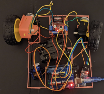

Step 14: Testing- Completing the Robot
Unzip the downloaded code file and add the Dabble library. Select the right board and port.
Download the code into Arduino IDE after plugging the USB A to B cable into a computer. It can be helpful to unplug the Bluetooth Clip during this process if there are difficulties successfully downloading the code to the Arduino.
If the code is downloaded, it will say "avrdude done. Thank you."
Then connect the robot to the Dabble app via the Bluetooth clip.
