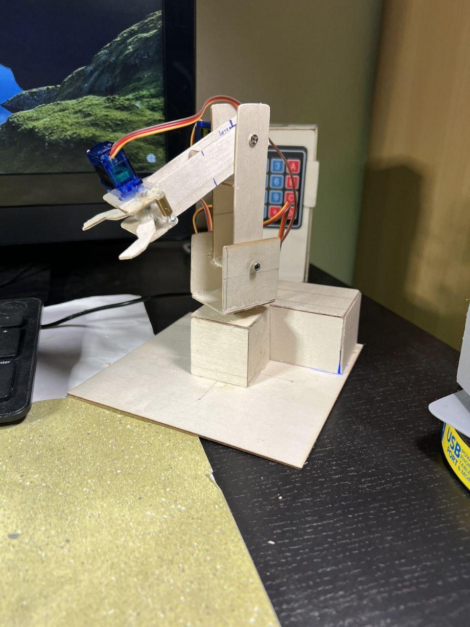

Introduction: Arduino Robot Arm
A handmade 4-servo robotic arm, handcrafted from wood and controlled via Bluetooth
Ideal for playing and learning arduino.

Step 4: Build the Body
Sorry but I didn't make enough photos for you :(
