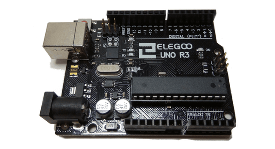

  1. Use two m4 screws, two plastic spacers, and two retaining nuts to secure the arduino in the center of the top chassis plate

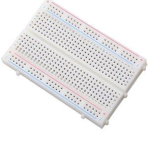

Step 3: Mount Breadboards, and US Sensors
  1. Use double sided tape to secure two mini breadboards at the front and back of the vehicle.
  2. Mount the Ultrasonic sensors in these mini breadboards
  3. Mount the half-size breaboard at the front of the vehicle, the side closest to the reset button on the Arduino board.

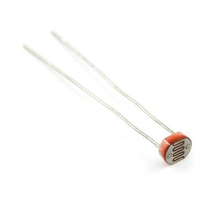

Step 4: Attach Photocells/photoresistors
  • Solder jumper cables to each leg of each photocell
  • Glue or tape the photocells so that the photoresistor faces towards the ground
  • Arrange both photocells about 2 inches from the center
  • tape or glue the wires leading to and from the photocells to the vehicle body

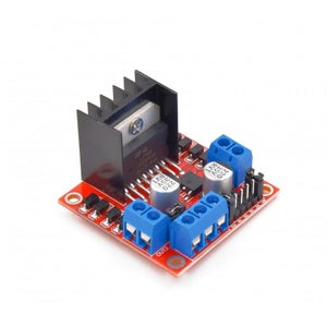

For the Motors
  • Wire the motors on the right side of the vehicle in parallel and the motors on the left side in parallel
  • For the right motors wire both positive cables and both negative cables to the OUT1 and OUT2 pins of the L298N motor driver
  • Repeat on the left side with the left motors and OUT3 and OUT4 respectively
  • ENA, IN1, IN2 goes to pin 3, pin 8, and pin 9 respectively
  • ENB, IN3, IN4 goes to pin 6, 10, 11
For the Battery Pack
  • Wire the positive lead of the battery pack to the 20V pin of the motor driver
  • GND to GND from battery to motor driver
  • Wire GND from motor driver to Arduino board
  • Use 5V output pin of motor driver to power Arduino board through Vin pin
For the Photocells
  • Connect one leg of each photocell to one leg of the 10k ohm resistor
  • Connect the other leg of each photocell to the 5V rail on breadboard
  • Ground the other leg of the resistor
  • In line with the leg of the photocell that is going to the 10k ohm resistor, connect the corresponding analog pins
  • The left photocell connects to A0, the right photocell connects to A1

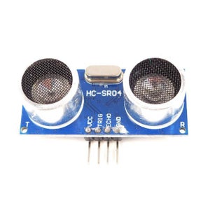

For the Ultrasonic Sensors
  • For all, VCC goes to 5V rail, GND goes to GND rail
  • The front US has TRIG pin 4, and ECHO pin 5
  • The back US has TRIG pin 13, ECHO pin 12
  • The right US has TRIG pin 7, ECHO pin 2

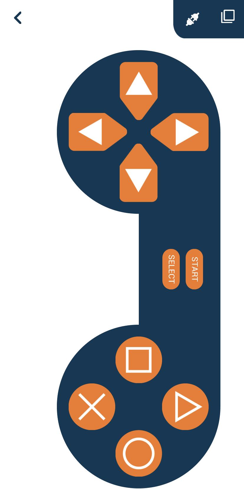

Step 6: WIFI Control Code
  • This code utilizes the Dabble ios app
  • Use the connect feature in the upper right corner of app and select BT05 to connect to HM10 module
  • The beginning of the code enables and identifies the EN and IN pins for both sets of motors left and right
  • The code utilizes if else statements to correspond the gamepad up, down, left and right buttons on the app to the corresponding forward, back, left and right outputs of the motors

  1. Since the 0 and 1 pins are being utilized. These pins need to be unplugged when uploading code. The Arduino uses these pins to communicate with the serial monitor. Once the code has been uploaded these pins can be utilized
  2. Make sure to remove the Vin pin when uploading codes to Arduino board
