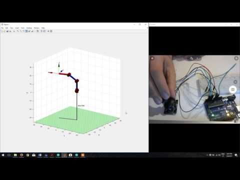

Step 4: CURRENTLY GOING ON IMPROVEMENT:
Since every joystick can control 2 servos (1 per axis), I need 3 servos to control the whole arm, but unluckily I only have 2 thumbs.
So I thought that, instead of controlling every servo, I could control only xyz position of the grip and open-close the grip, for a total of 4 axis, 2 joysticks and 2 thumbs!
I found out that that problem is well known as Inverse Kinematics, I also found out that it’s all but easy.
The idea is to write (nonlinear) equations to find the state of every effector (angles for the servos) given the final position.
I’ve uploaded a hand-written paper with the equations, and I’m currently working to a new code to use them. It shouldn’t be too hard, I basically have to read the joysticks, use their readings to modify the xyz coordinates of the grip, and then give them to my equations, calculate the servos angles and write them.
