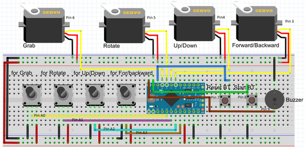

Step 2: The Circuit
The connections are pretty easy, see the above image with the breadboard circuit schematic.
Servo Motors:
- Servo for Grab movement to Arduino pin 6
- Servo for Rotate movement to Arduino pin 5
- Servo for Up/Down movement to Arduino pin 4
- Servo for Forward/Backward movement to Arduino pin 3
- All black cables to GND
- All red cables to Vcc - 5V
Potentiometers:
- Grab movement to Arduino pin A0
- Rotate movement to Arduino pin A1
- Up/Down movement to Arduino pin A2
- Forward/Backward movement to Arduino pin A3
- All left pins to GND
- All right pins to Vcc - 5V
Buttons:
- Teach button to Arduino pin 7
- Start button to Arduino pin 8
Buzzer:
- buzzer to arduino pin 9
