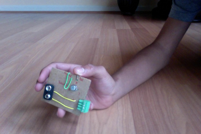

Step 2: Make the Power Distro. Board
Its critical to save weight on a rocket, and the power distro. board will take power from a 11v lipo battery and distribute it to the servo motors and to the arduino/sensors. Using the diagram i posted, make a distro board.
