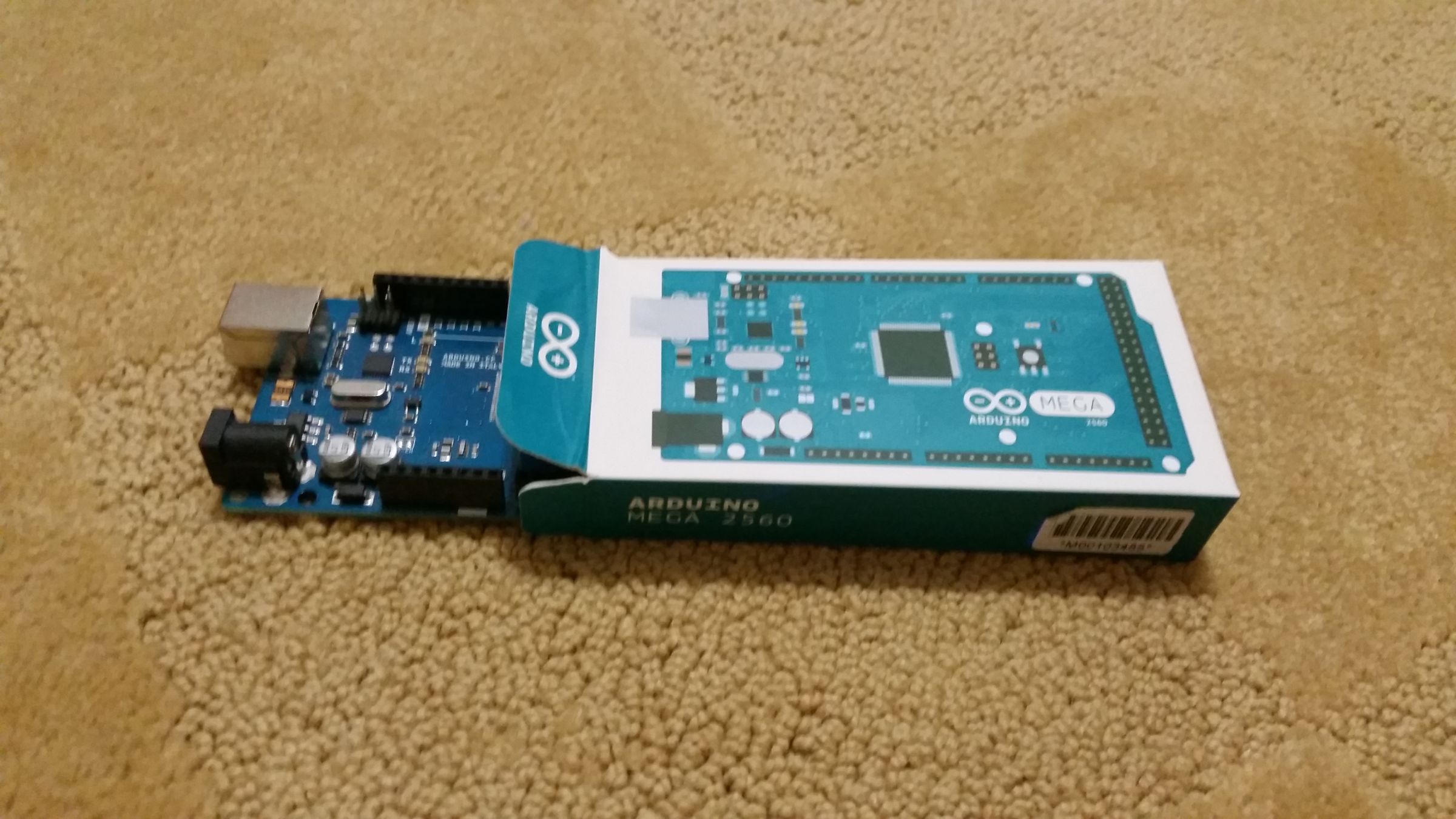

arduino board with tx rx pin and can supply 5 volts and has at least 4 digital pins for each servo.
