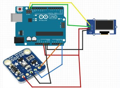

Step 3: The Circuit
  • Connect OLED Display pin [SCL] to Arduino pin [SCL]
  • Connect OLED Display pin [SDA] to Arduino pin [SDA]
  • Connect OLED Display pin [VCC] to Arduino pin [5v]
  • Connect OLED Display pin [GND] to Arduino pin [GND]
  • Connect SGP30 Sensor pin [SCL] to Arduino pin [SCL]
  • Connect SGP30 Sensor pin [SDA] to Arduino pin [SDA]
  • Connect SGP30 Sensor pin [VIN] to Arduino pin [5v]
  • Connect SGP30 Sensor pin [GND] to Arduino pin [GND]

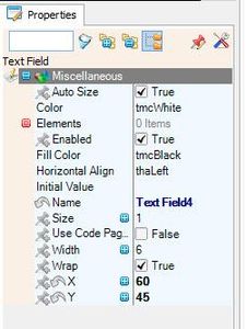

Start Visuino as shown in the first picture Click on the "Tools" button on the Arduino component (Picture 1) in Visuino When the dialog appears, select "Arduino UNO" as shown on Picture 2

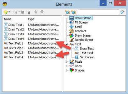

Double click on "DisplayOLED1" and in the "Elements" window drag 4X "Draw text" to the left side and 4X "Text Field" to the left side

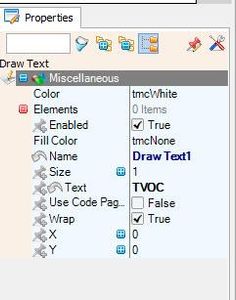

  • On the Left side select "Draw Text1" and in the properties window set Text to "TVOC"
  • On the Left side select "Draw Text2" and in the properties window set Text to "CO2" and Y to 15
  • On the Left side select "Draw Text3" and in the properties window set Text to "HYDR" and Y to 30
  • On the Left side select "Draw Text4" and in the properties window set Text to "ETH" and Y to 45

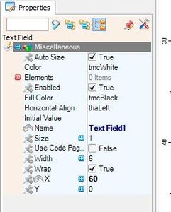

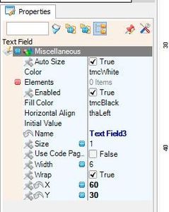

  • On the Left side select "Text Field1" and in the properties window set X to 60

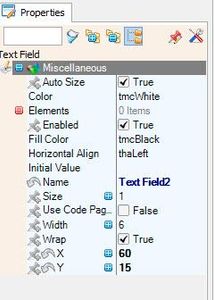

  • On the Left side select "Text Field2" and in the properties window set X to 60 and Y to 15
  • On the Left side select "Text Field3" and in the properties window set X to 60 and Y to 30
  • On the Left side select "Text Field4" and in the properties window set X to 60 and Y to 45
Close the "Elements" window

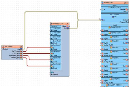

Step 6: In Visuino Connect Components
  • Connect "AirQuality1" pin [Out I2C] to Arduino board pin [I2C In]
  • Connect "DisplayOLED1" pin [Out I2C] to Arduino board pin [I2C In]
  • Connect "AirQuality1" pin [TVOC] to "DisplayOLED1" > "Text Field1" pin [In]
  • Connect "AirQuality1" pin [CO2] to "DisplayOLED1" > "Text Field2" pin [In]
  • Connect "AirQuality1" pin [Hydrogen] to "DisplayOLED1" > "Text Field3" pin [In]
  • Connect "AirQuality1" pin [Ethanol] to "DisplayOLED1" > "Text Field4" pin [In]

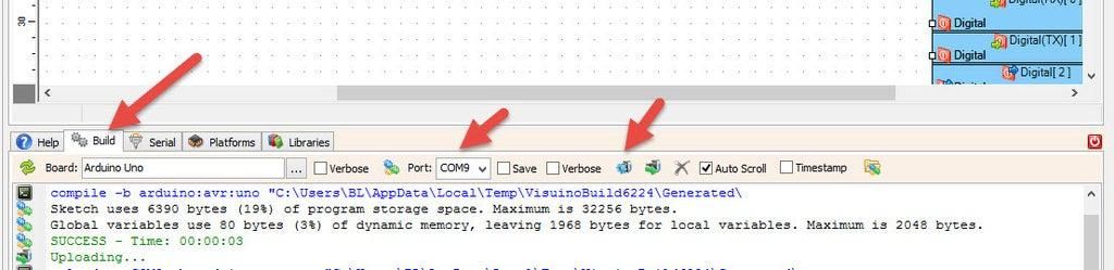

Step 7: Generate, Compile, and Upload the Arduino Code
In Visuino, at the bottom click on the "Build" Tab, make sure the correct port is selected, then click on the "Compile/Build and Upload" button.
