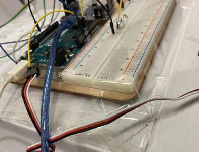

Step 1: Connecting the Circuits
- Connect all 7-8( depending on what kind of matrix board you are using) to the pins 13-7/6
- Connect the servo motor onto GND, 5v, and pin 4
- Connect the LCD screen onto GND, 5v, SCL, and SDA
- Connect the LED by letting the GND pass through the 100Ω resistor, and linking a random pin to it as well

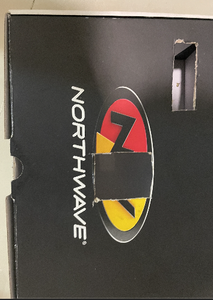

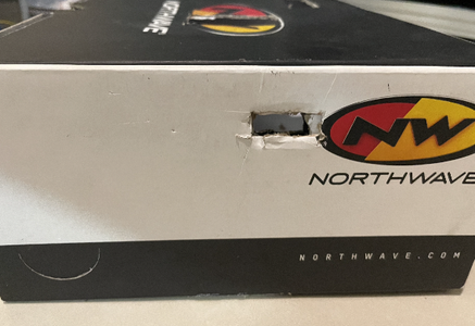

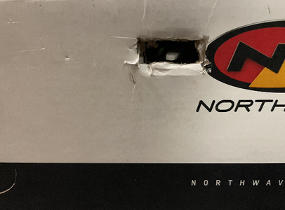

- Cut a 2x1 cm rectangular hole on the side. This is for the motor to have a hole that locks the lid in place

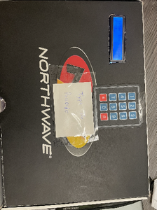

- Cut a 7x5 cm rectangular hole on the front. This is for the LCD light to go through the whole
-Cut a 4x2 cm rectangular hole in the front. This is so that the lines, which is following the matrix keyboard could connect to the matrix keyboard outside.
After creating the safe, one would have to make sure of the sustainability of the box. If the box is fragile, then consider switching to another box.
Step 4: Assembling the Safe
After finishing the modifying of the box, we then have to station all of the wires and breadboard inside the top of the box. Therefore, when opening the box, it wouldn't be as messy. I used tape for stationing the boards, sticking them onto the box, so it doesn't fall down. I also redid the part where the motor was supposed to be placed since the angle is of huge importance in successfully locking and unlocking the safe. The angle needs to be precisely correct in order for the project to work. I also recommend using heavy-duty tape, since the normal tape is too thin and not sticky enough to hold the weight of the boards.
