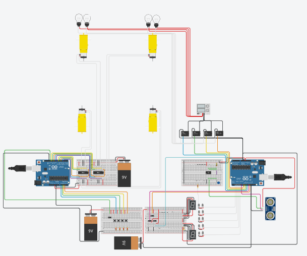

In this step you will wire the first two digits of your combination, each LED on the main breadboard represents a digit of the combination, if it's on then that's a 1, off is a 0. The two NE555 timer circuits act as the last two digits, the mode the timers are wired in is bistable mode, this allows the timer to act as a flip-flop circuit, flipping the LED from on to off using two push buttons. We are going to wire two of these circuits on the far left of the main breadboard.

In this step you will wire the next two digits of the combination in the form of a gated SR latch, the reason it is gated rather than not is to avoid the "illegal" state of both inputs being 1, so this adds a third input, enable. This latch acts similar to the bistable mode NE555 timers in the terms of it is a flip flop circuit, but it flips between two LED''s instead of just one. Since the latch is gated you must hold the enable button to be able to use the other two buttons to switch between the two LED's. This will be wired on the same breadboard used for the two NE555 timer circuits.
In-Depth Steps:
First take the breadboard from the last step, directly to the right of the furthest right pushbutton connect the two ground rails of the breadboard with a jumper wire, do the same for the power rail with a wire in between the two timer circuits. Next directly to the right of the wire connect the ground rails and place three push buttons over the middle of the breadboard with no spaces between them. for the first two buttons connect the bottom left legs to the power rail with jumper wires and the connect the top right legs to the ground rail with 10k ohm resistors. For the third button do the same but switch the placements connect the bottom left leg to ground and the top right to power. Next one place to the right of the last button place the AND gate (7408) over the center of the breadboard, make sure the notch on the chip is facing to the right. Then two places over place the NOR gate (7402) over the middle of the breadboard, ensure that the notch in the chip is facing to the left. Next complete the following connections between the two gates:
AND---------NOR
pin6 ------> pin11
pin8 ------> pin3
NOR--------NOR
pin2 ------> pin13
pin1 ------> pin12
Next connect the bottom right pin of the furthest left push button for the latch to pin10 on the AND gate, then do the same for the next pin over but connect the leg to pin9 & pin4 on the AND gate. Finally connect the last button from the top right leg of the button to pin5 of the AND gate. Then place two LED's to the right of the NOR gate one on the top and bottom, connect both short legs to the ground rails using 560 ohm resistors. Then finally connect the other leg of one LED to pin1 & for the other LED connect the other leg to pin3 of the NOR gate.

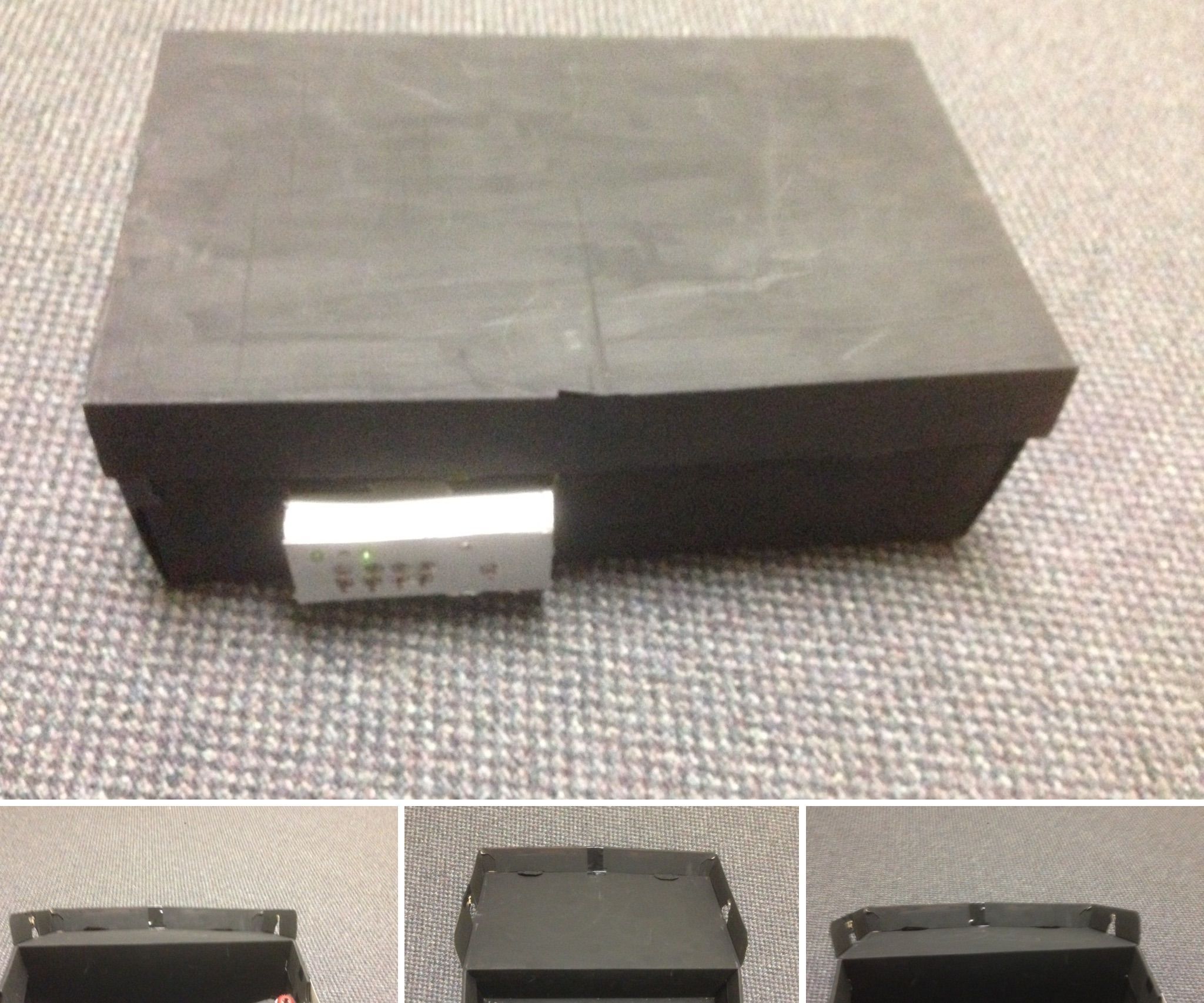

This is the system that the servo motor controls to actually lock the box it is housed in. The system is basically just sliding a dowel left and right to either block the lid from opening or not.
In-Depth Steps:
First hot glue popsicle stick or thin piece of wood to the inside wall of the box, have the wood be higher than the wall but short enough so the lid can still close. Then drill/cut a hole into the lid of the box going through the box and the center of the wood you just glued in to the box. Next take a piece of the larger sized dowel and cut a hole in the middle the size of the medium sized dowel to allow it to go through, next glue the piece of large dowel to two popsicle sticks to act as legs. Line up the hole in the dowel to the hole in the piece of wood glued to the side of the box and glue the legs of the dowel to the floor of the box. Now cut a piece of the medium sized dowel that is long enough to go through the large dowel and hole in the wood glued to the box. Then place the servo motor behind the legs of the dowel and glue it in place, now cut a shorter piece of the medium sized dowel that goes from the servo to the end of the dowel that is going through the dowel and lid of the box, and glue it to the servo motor end. The drill a hole in the back of the horizontal medium sized dowel and the top of the one glued to the servo so the holes line up then cut a piece of the smallest dowel and place it in the two holes you made, this acts as a hing so when the motor moves back the dowel glued to it it pulls back the one sitting horizontal.

This part is very simple, we are just building a cover for the mini breadboard on the outside of the box with the dip switch and RGB LED. This is so it will look better and protect the components and cover up wiring.
In-Depth Steps:
First cut 4 popsicle sticks the length of the breadboard plus half an inch and then cut four popsicle sticks the width of the breadboard. Glue these together creating a rectangle two popsicle sticks high, then cover the top in popsicle sticks cutting out space so the RGB LED and dip switch are still visible. Then drill a hole in three corners of the breadboard cover you just made the size of your wooden dowel, then drill three holes in three different popsicles sticks the same size. Next cut down the popsicle sticks so the holes match up with the ones in the cover and the sticks are long enough just to go past the height of the cover, Next glue the popsicle sticks with the holes in onto the front of the box so the cover can fit between them, ensure the placement will cover the hole where the wires are fed through. Next cut dowels and insert them into the holes so it holds the cover & breadboard on the front of the box.

Step 9: Finished
Congratulations you have now built, wired, and coded your very own DIY safe, you can now keep your valuables safe from others. I hope this was a helpful tutorial and you can make your own fun and secure DIY safe.
