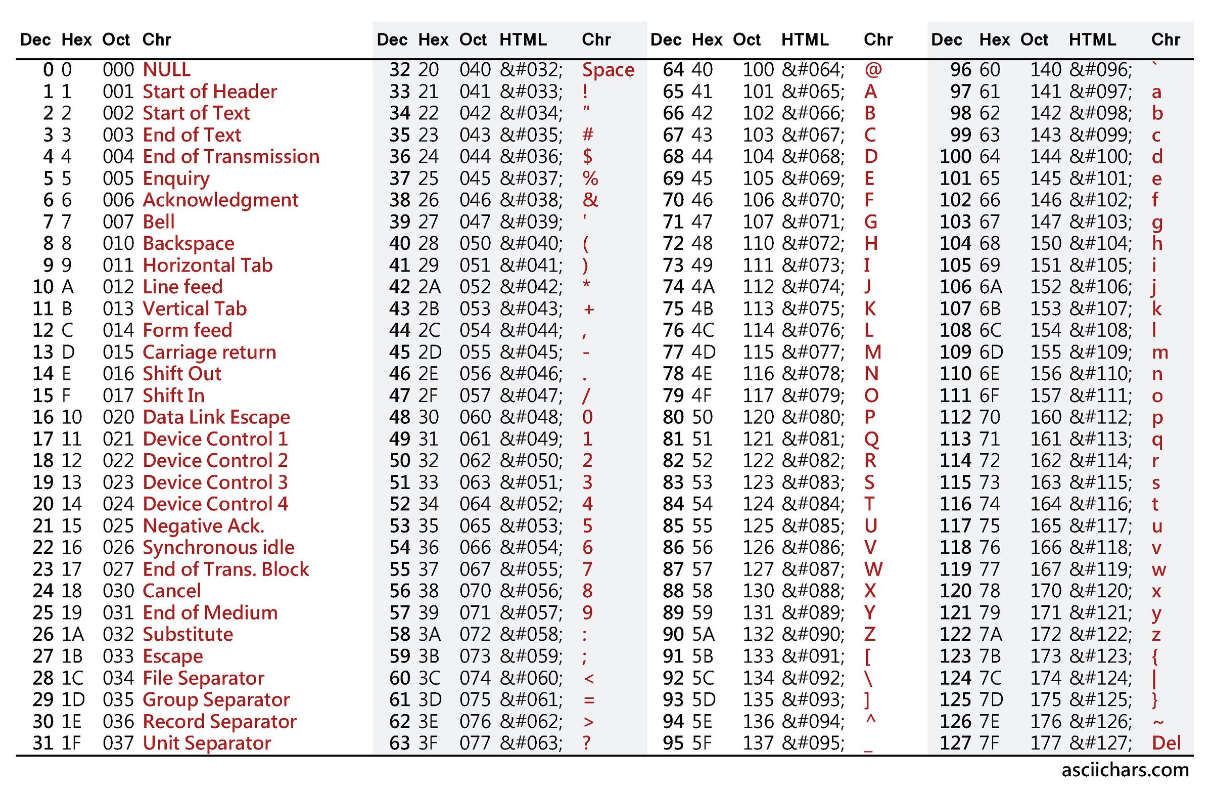

On an Arduino we can transmit up to 32 ASCII characters, or bytes, at a time using I2C, which is much more useful, and the character set includes numbers, letters and control characters in 7 bit format as below:
Fortunately, the Arduino compiler does all the work of conversion from character to binary in the background, but it still expects the correct type of character for data transmission and it won't accept 'Strings'.
