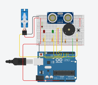

Introduction: Arduino Security System
This Arduino circuit will create a security system using an ultra sonic sensor to monitor the specific area. The system will have an ultra sonic sensor attached to a servo, moving across continuously while measuring the distance between the sensor and the objects in the area. If the sensor detects an objects that is too close, it will trigger a buzzer as well as an LED to notify the presence of the object. This security system is a simple and affective tool for basic perimeter monitoring.
Step 1: Materials and Cost
For this project, you need the following materials:
4x resistors: Three 330 Ω resistors ($0.87 each), One 10K resistor ($0.12 each)
1x Buzzer ($0.52)
2x LEDs ($0.28 each)
1x Pushbutton ($0.08 each)
1x Servo Motor ($4.95)
1x Arduino Uno ($19.95)
1x Ultra Sonic Sensor ($4.99)
1x Breadboard ($4.16)
Wires ($13.99)
Step 2: Wiring
Buzzer = Pin 6
Red LED = Pin 7
Green LED = Pin 8
Pushbutton = Pin 4
Sensor Trigger Pin = Pin 9
Sensor Echo Pin = Pin 10
Servo Motor = Pin 5
Step 3: Upload the Code
In this code, the servo motor will continuously rotate with the ultra sonic sensor attached to it. When the sensor is able to detect something that is too close, it will turn on the red LED and the buzzer, and make then continue to go off until the object that was detected has moved away. When the ultra sonic sensor is unable to detect anything, the green LED will stay on, only turning off when the sensor is able to detect an object. The button on this circuit automatically turns on the buzzer and the LED, having both turn on and off 3 times before stay on, when the button is pressed, the servo will stop moving as well as the ultra sonic sensor not controlling the buzzer and the LEDs.
