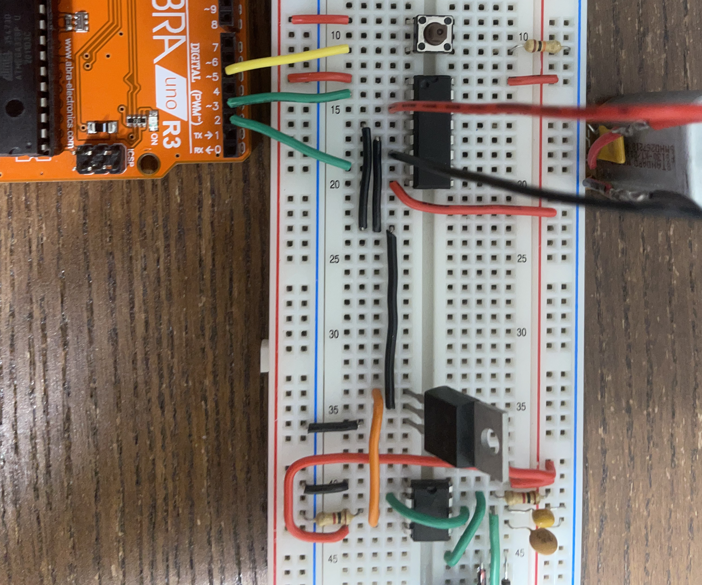

Step 2: Wiring and Schematic (Part 1)
As you can see, the wiring for this project is not difficult to perform and understand. The sensors are located on one, single side of the breadboard while the output components, along with the button are located on the other side.
The input components, the sensors and the button, have connections to the ground and power rail as one can see them, and a connection to the Arduino Pins. The PIR sensor did require a 3-pin female to male jumper wire which runs underneath the breadboard so the circuit it convinient to look at.
The output connections, on the other hand, only require connection to the ground rail and the Arduino Pins. They are connected to resistors of appropriate measures to control them.
However, these images provided do not give a proper schematic view which is more advanced, easier to follow and more neat. The next part will provide a schematic view.
