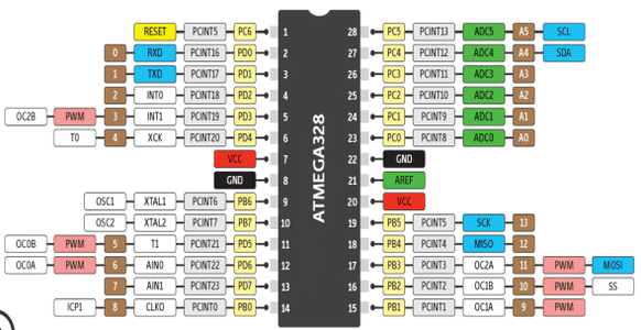

Step 2: Build the Circuit
Here is the most difficult step of this build. But don't worry just follow the schematic and check your connections once again before powering the board. If you face any problem while building the circuit feel free to Email me on 'thecyborglab@gmail.com'.
Pinout image is provided by:https://www.researchgate.net/figure/Atmel-MCU-ATmega328-and-the-Arduino-pin-out_fig10_312372376
