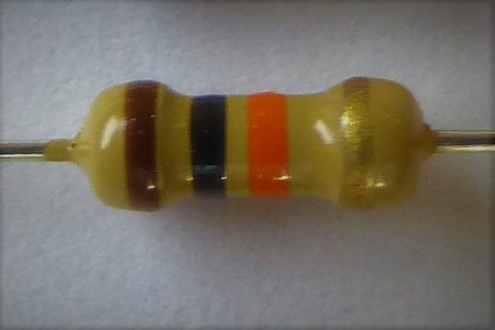

Step 4: Resistor

- A0 pin (Blue wire in photo) to Force Sensor Pin with 10K resistor
