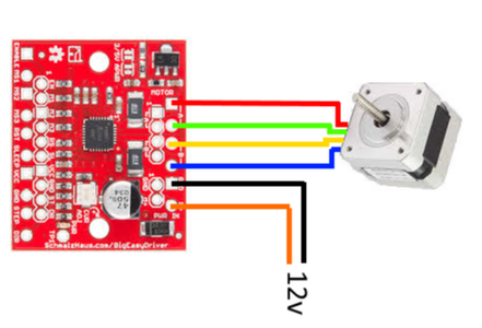

Step 1: Hardware Setup - Motor
First we need to connect the stepper motor to the driver board as shown above.
NOTE - it depends on the motor and the driver in use as to exactly how this will wire together

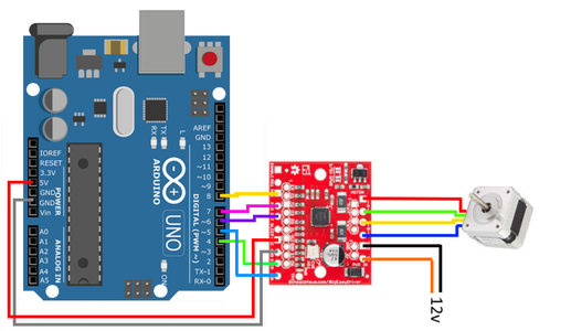

Step 2: Hardware Setup - Arduino Board
Then we can connect the driver board to the Arduino as shown above.

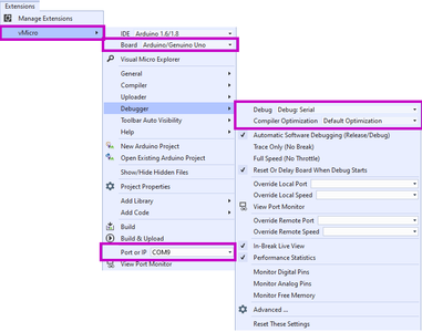

Step 3: Software Setup
(Steps 3,4 and 5 are covered in the video on Step 5 as well)
Here we just need to open Visual Micro and the program we want to calibrate, and set:-
- our board
- the COM port to upload and debug with
- Enable the Serial Debugger
