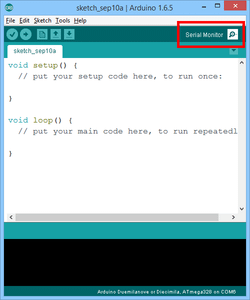

Step 3: Configure Arduine IDE
First of All open Arduino IDE.
next go to tools << Port<<(your COM Port ).
Then Click on Serial Monitor.
After that , a COM Port Window appears
Finally make sure from baud rate is 9600 by default.
