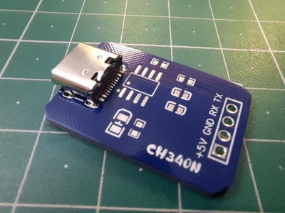

You can see the datasheet and application circuit of all of them from here. I want to make this programmer as small as possible. So, I bought CH340N ic, this one is available in 8 pin SMD package. No need of external crystal oscillator and need a very fewer external components.

1) CH340N IC
2) 1K resistor
3) 100NF capacitors
4) 0805 led
5) USB type-C
6) Custom designed PCB
Step 4: Circuit Diagram:
Here in the circuit 1K resistor is attached between the TX and RX pin. This pin further goes to microcontroller RX to TX and TX to RX for communication. This is USB to serial chip, so we are using TYPE-C, 100NF capacitors are used for filtration purpose. All the family of ch340 chips are compatible with 3.3 and 5volts. And CH340N has internal 8Mhz crystal, so need to give external clock. Led indicator with 1k resistor is for power indication. You can download circuit diagram and Gerber files from here.

Step 6: After Soldering:
I soldered all the components, it is not too difficult just done by hand soldering. First I placed USB and soldered that on place because this one has very intense gap between the pins.
Then I soldered all other components, IC, LED, resistor and capacitors and finally headers for the breadboard and jumper compatibility.

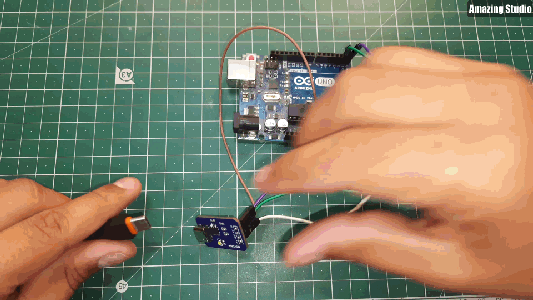

Connect your Arduino and ch340 module using this schematics here and then upload the sketch, but the problem of this IC will not ended up here. Because I am using lower variant of WCH named as CH340N. This one not have DTR pin that is required to reset the microcontroller before uploading sketch. So, you have to do it manually after compilation and before uploading.
If not then programmer will not flash the sketch inside the microcontroller and just stopped working like this. But we can use this programmer to upload sketch in other microcontroller and those 32bit ESP and pro mini also.

Everything is okay in WCH chips, But a chip without reset pin may create problem for newcomers in the MCU section. All the microcontroller has different boot programs, it work with pro mini very easily but for UNO we need to do many steps manually.
