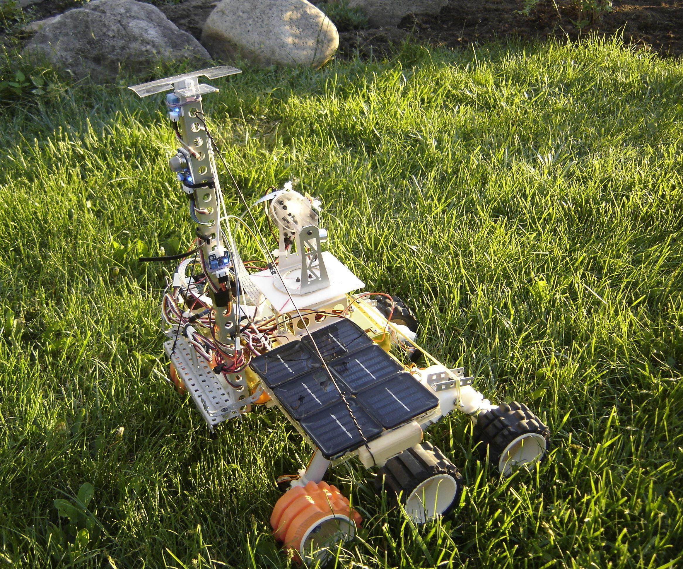

If you're doing this for yourself, still try to configure your board in a similar layout. You may not need the top cover, nor will you need 3 breadboards- but components need to be laid out in a logical way, such as the last photo of another project, which also uses a keypad and LCD. You can replace the circuit on the left with a breadboard, or omit it entirely.

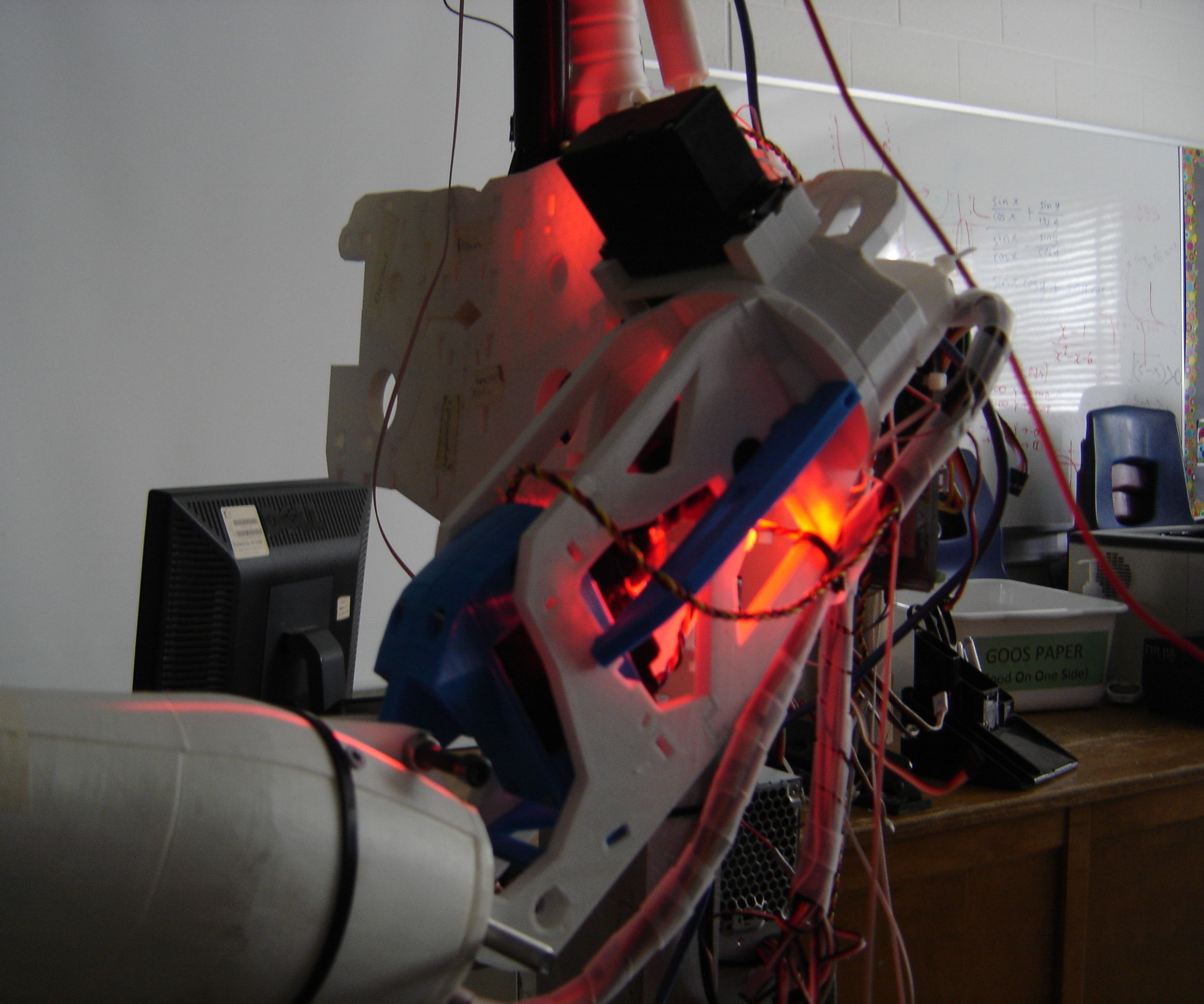

Now we'll take this project one step further and add a servo. You need to connect it to Digital Pin 10, as is set in the code, or you can change that to suit your needs. Follow the above Fritzing diagram; it is the same as the previous one with the exception of the servo, RGB common cathode LED and buzzer. The latter two are used to supplement the user interface- warnings and status will be displayed on the LED and through the buzzer. We see above how we're using the completed servo tester to set limits for the InMoov Robotic Forearm and Hand.
