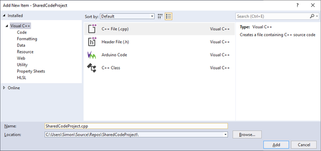

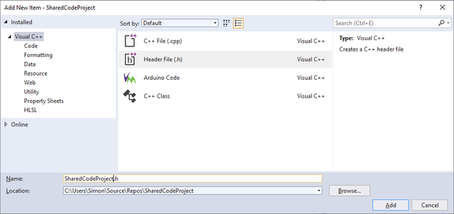

Step 1: Create Shared Project Code
Load VS > Create New Project > Arduino Shared Code Project
Here we can add the CPP and H files and any code we want to share between the PC and our Arduino projects.

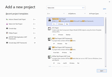

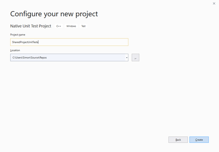

Step 2: Create Unit Test Project
Right Click on Solution > Add > Project / File > New > Project
Add a "Native Unit Test Project"
