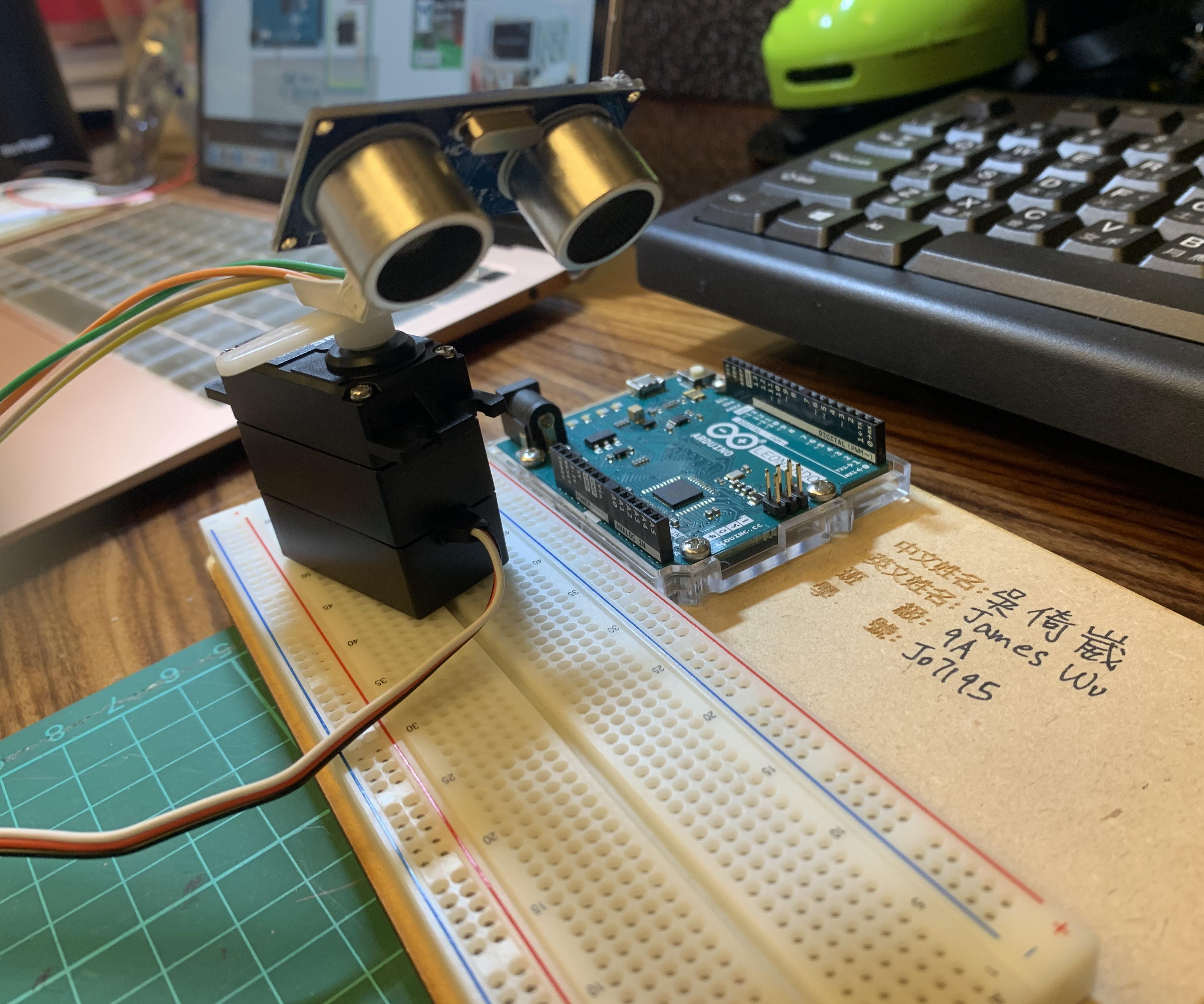

Step 2: Step 2: Arduino Wiring
The ultrasonic module wiring:
Vcc -> to Arduino 5v
Trig -> Arduino pin 3
Echo -> Arduino pin 2
GND -> to Arduino GND
First, you download the Make sure to put the wire in the right spot, or you may break it
Step 3: Step 3: Coding
Check the wiring, and upload the code on the Arduino. Then open the Serial Monitor, and move your hand above the module. The serial monitor should display a list of numbers... The distance in cm between him and you hand. The origan
Download the link below to get the code of "Arduino'' and "Processing"
