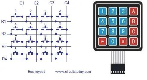

Step 4: Testing With Matrix Keypad 4x4
Use a 4X4 keypad with 16 buttons and 8 pins on the microcontroller. Programing to receive buttons to perform functions or receive data such as numbers to call, text messages.
Connect 4X4 Keypad to Arduino: C1-14 to A0-A3 and H1-H4 to Pin 9-12.
Link instructions and example code here:
  1. Interfacing Arduino with 4×4 Matrix: Link
