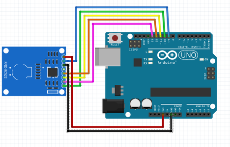

Step 1: Set-Up Reader
First set up the NFC reader. I did it according to the image.

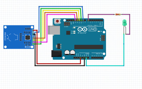

Step 2: Add LED
I added a LED to make it more clear for myself when the chip was being read. So I did that according the scheme in the image.

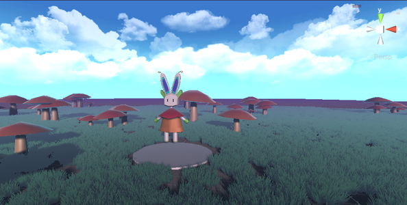

Step 4: Unity
Make a project in Unity. Add an asset pack called Ardity.
Add the SerialController script Prefab to your scene and make sure the right Port is added in the Inspector.
Then create a scene with a Plane, your character model and an Empty Game Object called SpawnPoint.
Create a new Script NFC reader. Write the following code:
using System.Collections;

This script makes sure your character spawned when the card reader reads the script. Change the UIDCHIPCODE to the name of your chip that appeared in the Serial reader earlier. We use the UIDs, so we could spawn more characters with different chips.
Don't forget to assign your Spawnpoint and Character model in the inspector.
You'll see that the model will clone itself. If you don't want to see a döppelganger of your character in the scene, just move it far away so it will be out of sight.

Lastly, I added a bit of an environment (assets from Polytope Studio), and glued the chip to the bottom of my model... and done!
