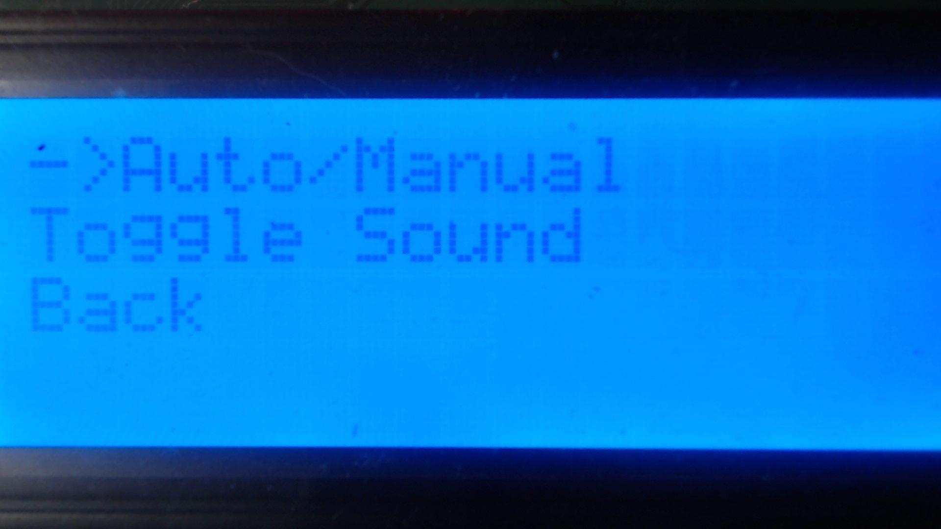

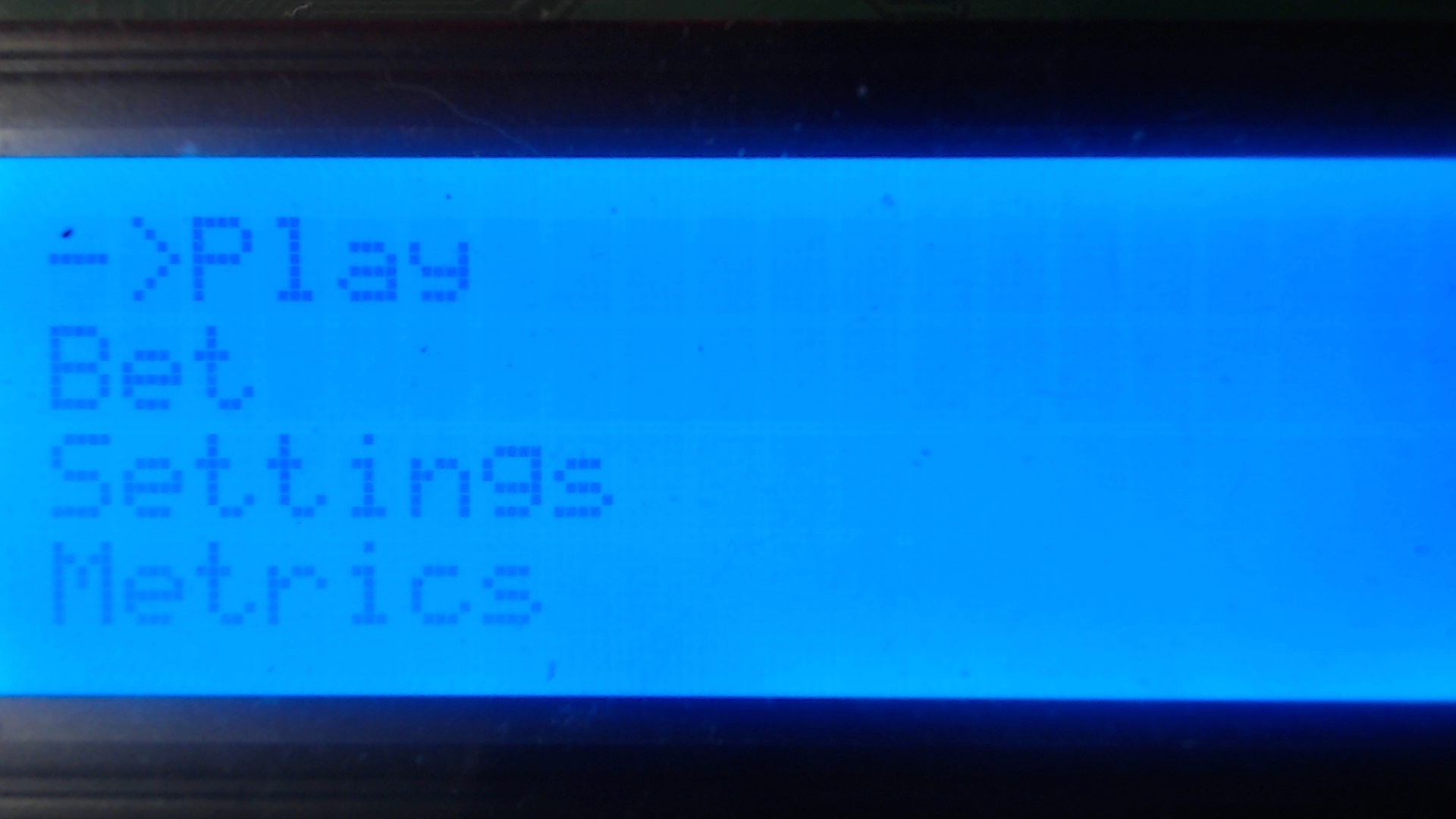

Step 2: Slot Machine Menu & Features

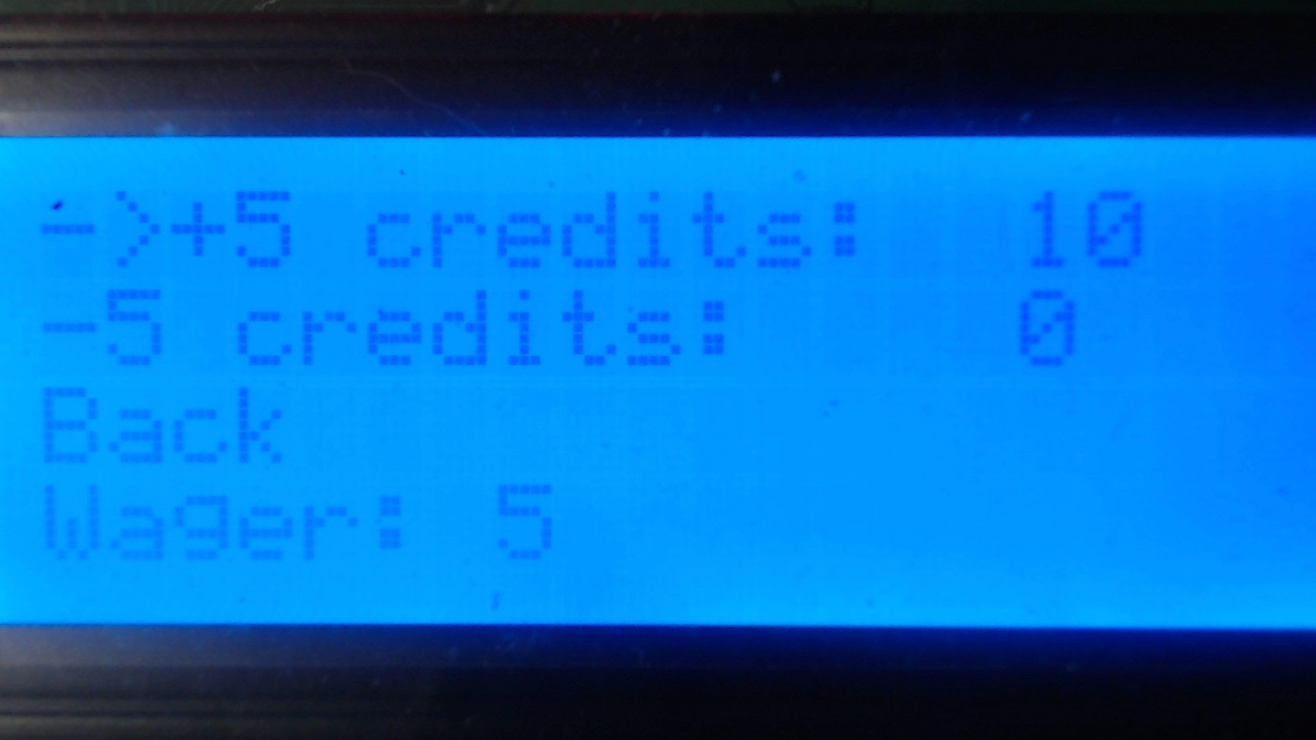

The slot machine has several interesting features which are accessed via the 20 x 4 I2C capable LCD display using two navigation buttons and a select button. The buttons use a fairly sophisticated de-bouncing algorithm that takes advantage of the micro-controller's external interrupt capability. This is the main menu.
Since there are six lines in the menu you have to scroll down using the 'navigate down' button to see the entire menu. There is a lever/knife switch dedicated to 'spinning' the reels. In addition to that you can also select 'Play' from the main menu. You can change your bet at any time.
The most exciting feature is that the game can be played in 'auto' mode; i.e. you select the auto mode option from the settings menu on the LCD screen and the game plays over and over again until you select the option again or 1 million plays have occurred. This is a critical function for testing the game. You can also disable the sound here.

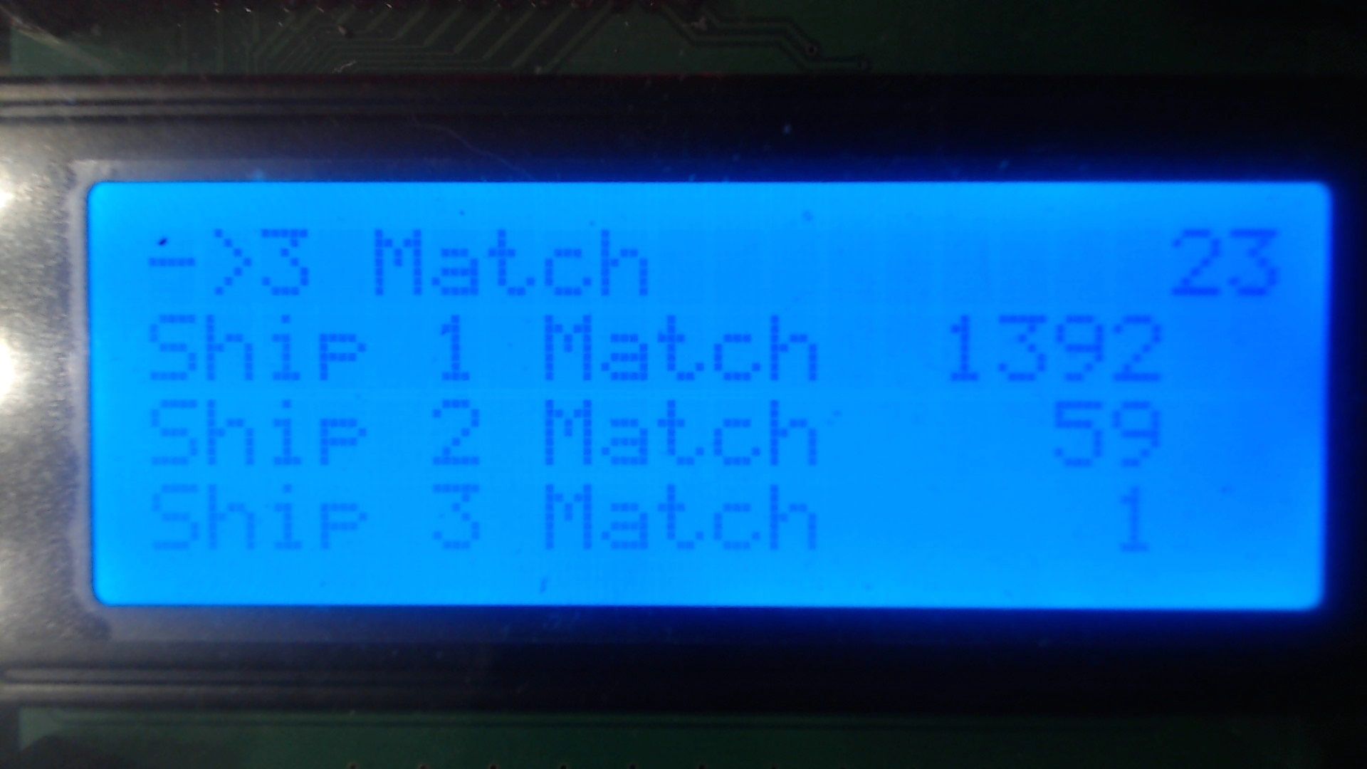

Via the menu on the LCD it's also possible to view all of the metrics generated from the simulation. These metrics are also output and may be viewed in the serial monitor if you connect your micro-controller to the monitor via the RX and TX pins using a USB cable. The list of displayed metrics includes your credit balance, the number of times you hit the jackpot, and the number of times you won credits by any other means. This allowed me to run simulations based on the various payouts, and was useful for establishing and proving out the payout table. The payout table itself is not configurable; once it is set it should stay the same. I suppose it would be possible to make the volatility index configurable by using it to drive the payout tables, but that would require a lot more work.

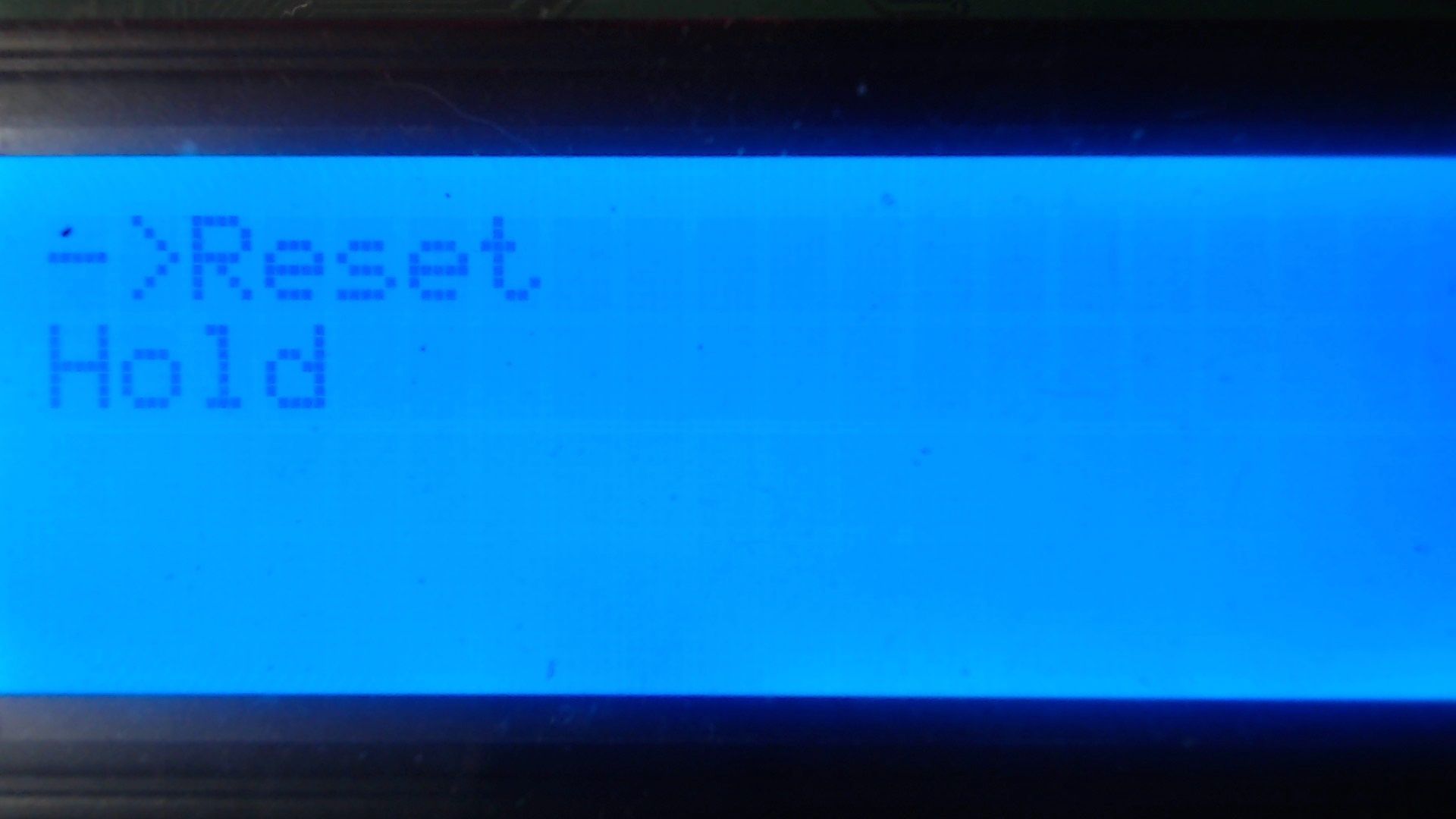

The Reset option allows you to reset all of the metrics (except EEprom writes), back to zero. The chip will work for about 100,000 writes to EEprom. Since there's 512k of EEprom available on the chip, and we're only using a fraction of that, it would be possible to actually move the location of the metrics in EEprom as we approach 100,000 writes. I have not implemented this feature but it would be a means by which to extend the life of the chip.

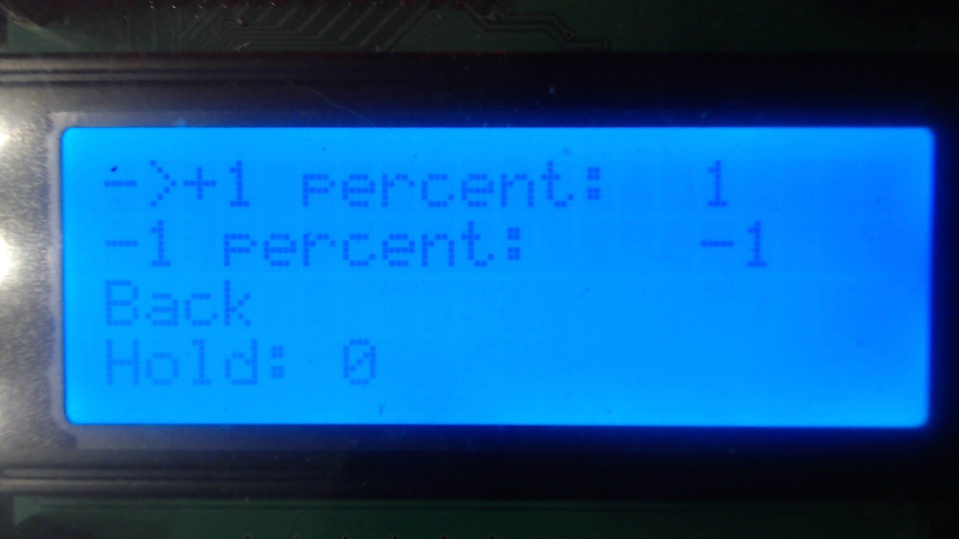

Finally, the hold, or the percentage of each wager kept by the house (over time), is configurable. Remember that after performing a Reset operation the hold needs to be set again.

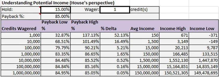

A lot of work went into making sure that the game was realistic. The probabilities were calculated and the payout table was designed so that the game has an acceptable Volatility Index (VI). This index measures how predictable the machine's behavior is. A machine with a higher VI is more likely to make the player (or the house) more money. It is less predictable than a machine with a lower VI. It's true that the same exact game will exist in different casinos (or even the same casino) with different VIs. The VI is changed by manipulating the payout schedule. For our game here are the probabilities and payouts for each kind of win.
Note that the odds (far right) and the payout (far left) are dramatically different. If this game was programmed so that the payout table matched or closely followed the odds, it's VI would be unacceptably high. The hold is calculated as a percentage of the payout, and is the portion of a wager kept by the house/casino. As stated you can set the hold via the LCD menu. Bear in mind that different jurisdictions have different regulations that govern the maximum hold for slot machines in that jurisdiction. A typical maximum hold is 15%. Understand that setting the hold to the maximum allowed by law doesn't necessarily maximize the profit generated by that machine, because a higher hold might discourage players from using the machine. I suspect, however, that many players ignore the hold, which is typically buried in fine print, and that the demand curve for a machine is relatively vertical (meaning that the cost of using the machine, the hold, is largely ignored), and that profit generated by the machine is far more dependent on the location or placement of the machine as well as the design of the game itself. But that's just speculation. I'm sure there are some savvy gamblers out there who are sensitive to the hold.
The spreadsheet, available with the code, with three tables was built to prove that the game is working correctly (the first table appears above). The first step in building the spreadsheet was to accurately calculate the odds of each type of win (the Calculated Probability columns).

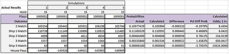

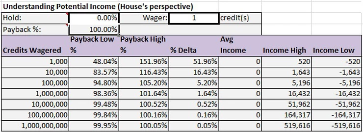

Now that I have the probabilities for each kind of win I can use the spreadsheet to design the payout table in a way that makes the volatility index acceptable (< ~20). To understand how to do this I relied heavily on thisthis post. I entered values in the House Income column of the first table, using a process of trial and error, until the VI was under 20 and the Total in cell J10 was as close to zero as I could get it. Using those values I set THREE_SPACESHIP_PAYOUT, THREE_SYMBOL_PAYOUT, TWO_SPACESHIP_PAYOUT, ONE_SPACESHIP_PAYOUT, and TWO_SYMBOL_PAYOUT in SlotMachine.ino accordingly. Then, first by using a hold of zero percent, I ran five simulations of 1,000,001 plays, and entered the values from the metrics menu into the appropriate rows and columns in the Actual Results table.
I observed that the Probabilities Actual closely tracked with the Calculated probabilities, and that the Pct Diff Prob column was reasonable. I also matched the values in the House Pays row up with the range of values from the Income High and Income Low columns of the 1,000,000 row of the Understanding Potential Income table (the second table), and observed that the values from the Actual Results table were inside of the range specified by the Income High and Income Low columns. The Understanding Potential Income table defines the expected range of income for a given hold value with a 90% confidence interval. In the example below the hold is set to 0, so the likelihood of winning match the likelihood of losing. If you play the game 1 million times there is a 90% likelihood that the Income will be between 16,432 and -16,432.
After working with the spreadsheet and the program and running millions of simulations I was able to work out the defects in the program, to address the defects in the spreadsheet and to define values for the payout table that kept the VI < 20. Finally I changed the hold to 15% and ran another set of 5 simulations to verify that the game's income is in line with expectations if it were to be deployed in a real world situation Here is the income table for a 15% hold.
And here are the actual results.
If you want to really understand all of the math behind setting the payout values I encourage you to examine the formulas in the spreadsheet. If you find any errors kindly point them out to me; I am not a mathematician (or a C programmer) by trade, so the standard disclaimer applies.

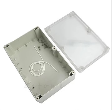

Here is the enclosure I've ordered, into which I'll insert the components:
This item is available here for $13.80. That's a little on the pricey side in my view. I'm hoping that everything will fit and that the top is very transparent so that I don't have to cut holes in it to see the reels and the credit balance display. We'll see how it goes when it gets here! Suggestions welcome.

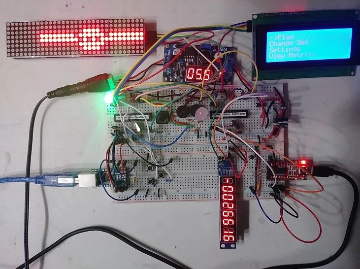

Step 5: Building the Circuit
The Fritzing schematic is available here.
Below I've included a directions on wiring the micro-controllers, because the Fritzing diagram is crowded. This doesn't represent all of the connections necessary, but it should clear up any confusion. I haven't grounded all of the unused pins, but I am probably going to do that in the final product. If you're having trouble following the Fritzing diagram with respect to setting up the circuitry for the power supply, remember to look here, under Adding circuitry for a power supply. Remember to add the switch between the breadboard ground rail and the power supply circuit so that you can power the circuit off and on without having to unplug or disconnect the power supply. That will be important when we put everything into an enclosure.
