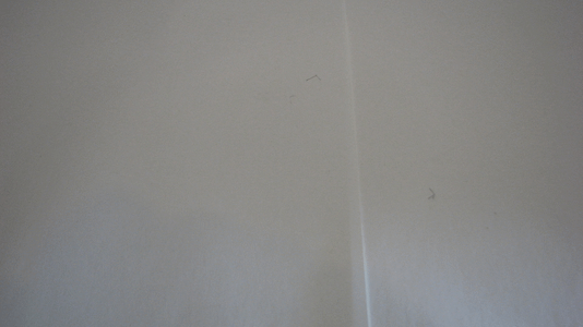

Step 6: Wall Mounts
At the end, I mounted both of units on the wall after installing the power supply and the digital data cables.
