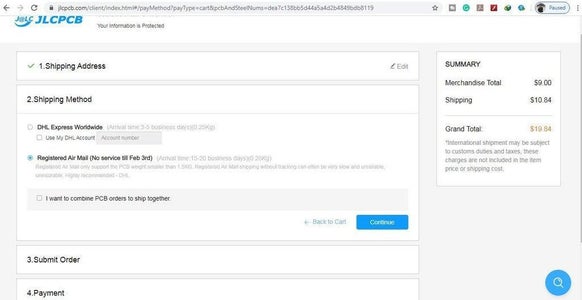

Step 7: Order the PCB
After downloading the Garber file you can easily order the PCB from JLCPCB.
1. Visit https://jlcpcb.com and Sign in / Sign up.
2. Click on the QUOTE NOW button.
3. Click on the "Add Gerber file" button. Then browse and select the Gerber file you have downloaded.
Step 8: Uploading the Gerber File and Set the Parameters
4. Set the required parameter like Quantity, PCB masking color, etc
5. After selecting all the Parameters for PCB click on SAVE TO CART button.

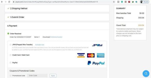

Step 9: Select Shipping Address and Payment Mode
6. Type the Shipping Address.
7. Select the Shipping Method suitable for you.
8. Submit the order and proceed with the payment. You can also track your order from JLCPCB.com.
My PCBs took 2 days to get manufactured and arrived within a week using the DHL delivery option.
PCBs were well packed and the quality was really good at this affordable price.

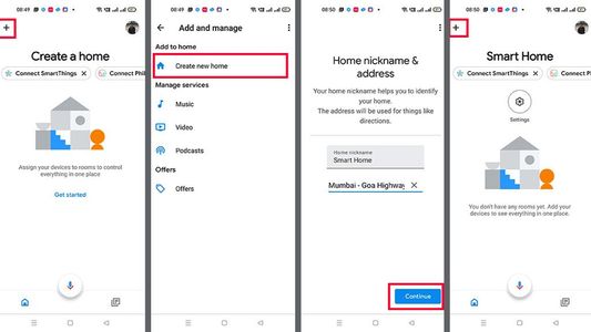

Step 13: Setup the Google Home App
First, download and install the Google Home App. then follow the steps to create Home in Google Home app
  1. Tap on the "+" icon (upper left corner).
  2. Tap on Create new home.
  3. Enter the Home nickname and address.
  4. Then click on Continue.
The Home is created. Now again tap on the "+" icon to add devices.

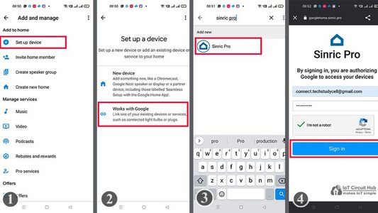

Step 14: Connect Sinric Pro With Google Home App | Add Devices
After creating the Home in the Google Home app, you can connect the Sinric Pro with the Google Home app
  1. Tap on the "+" icon, then select Set up device.
  2. Tap on Works with Google.
  3. Search for Sinric Pro, then select Sinric Pro.
  4. Enter the email id and password used for the Sinric account,
  5. Then tap on Sign in.
Thus, all the devices from Sinric Pro will be added to Google Home Account.

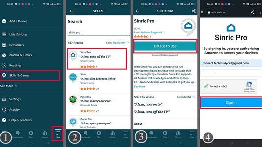

Step 15: Configure the Alexa App for This Smart Home System
Download and install the Amazon Alexa App from the Google play store or App Store.
  1. Go to "More", then select "Skills & Games".
  2. Search for Sinric Pro and tap on "Sinric Pro".
  3. Tap on "ENABLE TO USE".
  4. Log in with the Sinric account credentials.
Step 16: Connecting Devices With Alexa
  1. Tap on CLOSE.
  2. Tap on "DISCOVER DEVICES".
  3. It will take a minute to add devices. During this time the ESP-01 should be connected with the WiFi.
  4. Tap on "Devices", and tap on "Plug" to see all the devices.
Thus, all the devices from Sinric Pro will be added to Amazon Alexa App.
