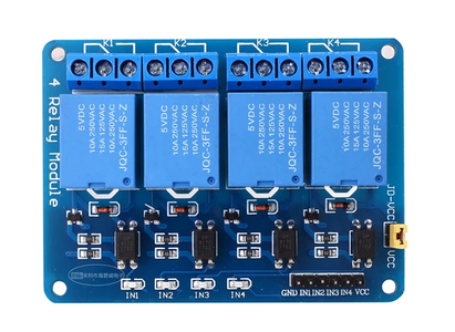

2) 4 Channel 5V Relay Module with Opto-coupler

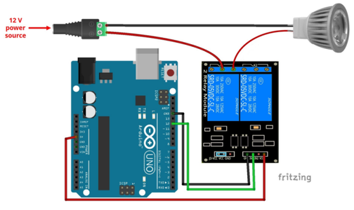

Step 1: Arduino Schematic
I like to begin my Arduino projects by mocking up the wiring using bread boards and jumper wires. Adding each component one by one, ensuring that I have hooked them up correctly and they are giving the expected results. So follow the above diagram to construct the control unit.

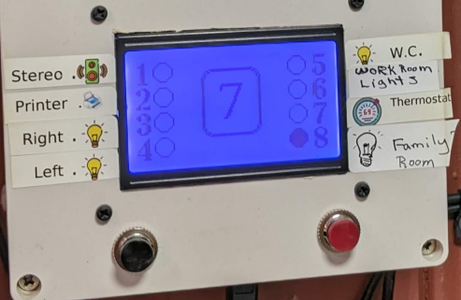

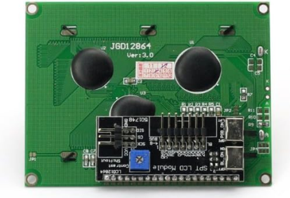

I used a 128 x 64 LCD display that is compatible with the U8glib graphics library. This creates a User Interface (UI) to the 8 relays. The black momentary button will allow you to select a relay. The Red button will invert the current state of the relay (like a light switch).
Connect:
  • pin 14 (A0) to SCK
  • pin 15 (A1) to CS
  • pin 16 (A2) to SIO
  • GND to ground
  • +5V to VCC
  • pin 2 to black momentary switch
  • pin 3 to red momentary switch

Now that the UI display is working and you are able to trigger relays, it's time to assemble all the components in the project box. And connect the display and relays to the Arduino. You might notice that the relay on the left bottom (ie relay #1) is not used. It has been replaced with a solid-state relay (SSR). The reason is that relay #1 turned the Stereo System on/off. The mechanical relay introduced EM noise into the system and you could always hear a faint buzz from the speakers. The SSR helped solve this problem.

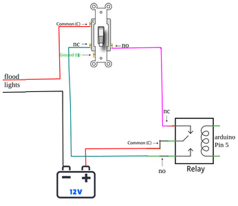

If this device is your sole means to active your lights or devices then your done! If want to be able to turn on lights or a printer manually or programmatically (ie from your PC or smart phone) then you have to wire the device/light like you would a 3-way switch. Fortunately, these opto-coupler relays are built the same way a 3-way switch from the hardware store was built.
Review the 2nd wiring diagram and you see how a light can controlled by this device or a regular light switch. Note that on the wiring diagram: nc = normally closed, no = normally open
