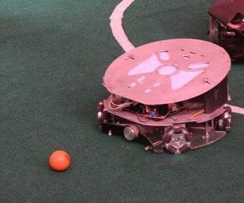

Line Following Robots are the most common icon for building any robot.Line followers are the stepping stone towards robotics.
Now we have been blessed with Arduino and bunch of good not just good but great sensors.so be smart and don't waste your time in making complex circuits with separate sensors.There are bunch of sensor modules available in the market with built in comparators.
so wisely choose what you are going to do and what you have to do. We will see some of the very common and effective ways of making line following robot.We will start from basics and in further tutorials we will follow some complex algorithms.we will see PID implemented robots and some advance techniques in making smart robots.
