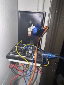

Introduction: Arduino Smart Switch
The smart light switch is a simple solution to turning on and off lights. The switch is distance and light sensed and it can be easily swapped to meet different needs. The switch utilizes a servo motor and a bracket on a custom switch plate designed in CAD. All files and code are below!

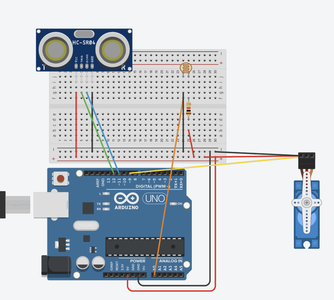

Step 2: Construct Arduino
Wire the Arduino and breadboard matching the diagram above. The breadboard will be taped upside down on the shelf part of the switch plate and the Arduino will sit on the bottom.

Attach to the switch and adjust values as needed (timing, degrees, distance, light levels, etc.)
Step 4: Add New Components
Add and experiment with new components such as a piezo buzzer or temperature sensor! Set the timing for bedtime reading or routines! If adjustment on the motor is needed, attaching string around the motor and switch is an alternative method. Enjoy!
