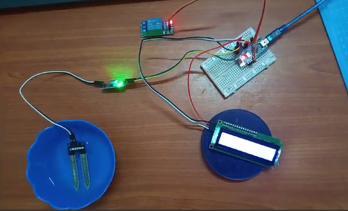

an Arduino-based automated watering system using an LCD with I2C communication and a relay to control the water pump. This example assumes you have a soil moisture sensor to detect the moisture level.

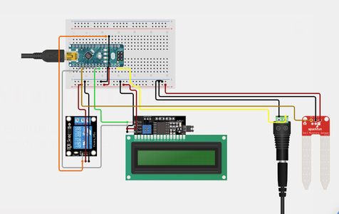

Step 1: Wiring Connections:
Soil Moisture Sensor:
  1. VCC to Arduino 5V
  2. GND to Arduino GND
  3. A0 (Analog output) to Arduino A0
Relay Module:
  3. IN1 (control pin) to Arduino D2
I2C LCD:
  3. SDA to Arduino A4 (for Uno/Nano)
  4. SCL to Arduino A5 (for Uno/Nano)

Step 5: Testing:
Make sure to test the system carefully. Start with the pump connected to a power source, but not with water until you confirm the relay operates correctly.
