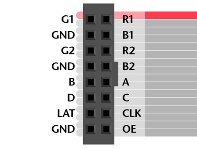

Step 2: Circuit Diagram
This circuit diagram shows the physical connections required to make this project function. Note that we could not display the ribbon cable on the circuit diagram, but we have listed the connections needed to make the project function. The second image is of the ribbon cable with labeled connections for reference when assembling. Note the three grounds on the ribbon cable. Those grounds can be connected to the common ground on the breadboard, or to grounds on the Arduino. More on physical assembly can be found in the manufacturing/ assembly section. The connection to pin A5 is not connected to anything intentionally, but still has a short jumper in it.
If assembling this project on a breadboard: follow this circuit diagram for building your project.
If assembling this project with the 3D printed housing: see manufacturing/ assembly section for more information on wiring.

Assembling this project is fairly straight forward if you do not choose to 3D print the housing. Without the 3D printed housing the project can be assembled on a breadboard, and the Arduino can be plugged into a computer to power it. Using the 3D printed housing requires a few additional steps. One of those steps is drilling some holes for the M3 mounting screws to pass through to the panel. The biggest one of note here is dealing with the ground connections from the ribbon cable. There are three ground connections from the ribbon cable, one from the joy stick, and one from the buttons, but there are not five grounds on the Arduino. We chose to solder together the three ground connections from the ribbon cable to make one singular connection to the Arduino. If you are using a breadboard you can skip this step.
Note in the first image in this section the screw driver is showing the ribbon cable going to the input channel on the LED panel. It is important to connect the ribbon cable here for proper operation.
The supplied power and ground cable for the LED matrix came very long, so we shortened the cable to make for easier wiring in the 3D printed housing. The connection from the cable to a power source was circular and had to be cut to fit into the barrel jack. This barrel jack is where the power supply plugs in and powers the Arduino, buttons, and joystick. Note in the last image that the supplied power cable was cut and jumpers were soldered in to provide power to the previously mentioned components.
If this project is being built on a breadboard we recommend powering the Arduino with a computer and sending 5V and ground to the breadboard, this will make the connections much simpler.
