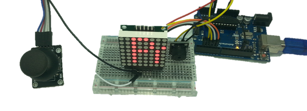

Here's the first of our mini projects that you can build from (max7219,buzzer,arduinouno & joystick). It's a take on the old 'Snake' game that you might have seen on old Nokia phones or even earlier on Atari. There's nothing difficult about this project but we'd recommend that you've built a few of the designs from the book before attempting it.

Step 2: Connections
D2- Joystick(SW)
D3-BUZZER(S)
D4-MATRIX(DIN)
D5-MATRIX(CS)
D6-MATRIX(CLK)
A0-joystick(VRx)
A1-joystick(VRy)
5V-VCC +5V
GND-GND-GND
