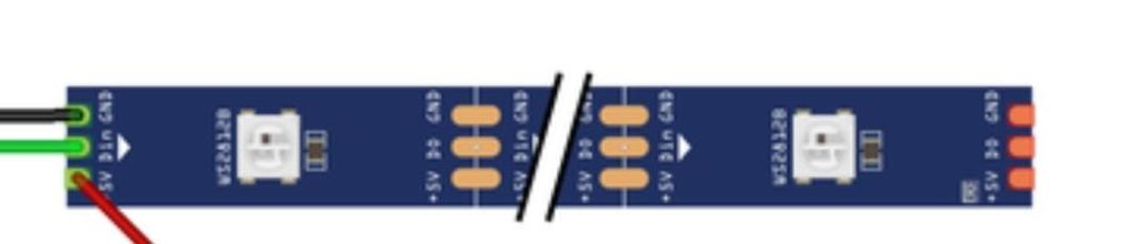

At a high level we have a matrix of ws2811 LEDs powered by an external 5V power supply. They were arranged in a serpentine pattern and form a matrix of leds 8 x 12. This game will work with any size matrix with minor adjustments to the code. We use an arduino to control the lights in the matrix. See the circuit diagram and material list for more information on the exact parts and wiring.
The only thing different about this setup from the previous project is we added a joy stick which will be used to direct the snake in the game. The analog stick is a basic analog stick that actually comes with an arduino starter pack, but you can also get it from Amazon. Refer to the circuit diagram for more information on how to wire up the circuit. Luckily the analog stick only requires 3 inputs for the ardunio, 2 analog inputs to read x and y direction of the stick, and a digital input to tell if the analog stick is pressed in. All of the wiring and power supply was hidden within the coffee table.
