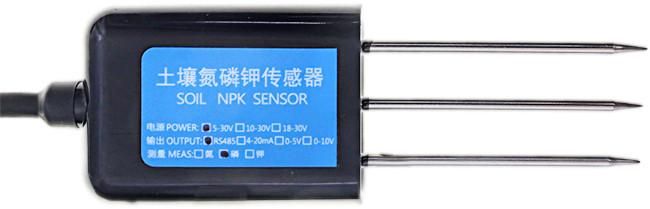

Step 2: JXCT Soil NPK Sensor
The JXCT Soil NPK sensor is a cost-effective, rapidly responsive, reasonably precise, and portable sensor. It facilitates real-time monitoring of NPK nutrient levels in soil for smart agriculture.
This soil NPK sensor can identify nitrogen, phosphorus, and potassium levels in soil (not water), aiding in soil fertility assessment for a more systematic understanding of soil conditions.
Operating on 5-30V with minimal power consumption, the sensor boasts a resolution of up to 1 mg/kg (mg/l) for nitrogen, phosphorus, and potassium measurement, as per the datasheet.
Featuring a rust-proof, electrolytic-resistant, and salt-alkali-resistant stainless steel probe, the sensor is adaptable to various soil types, including alkaline, acidic, substrate, seedling bed, and coconut bran soils.
The probe is securely sealed with high-density epoxy resin to prevent moisture ingress.
Moreover, the sensor holds an IP68 rating, ensuring protection against dust and moisture, ensuring prolonged operational longevity.
For extended-range usage, the sensor incorporates an RS485 communication interface supporting the Modbus-RTU communication protocol.
