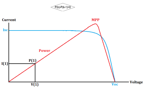

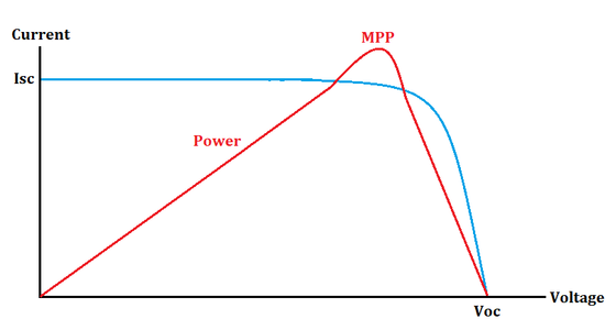

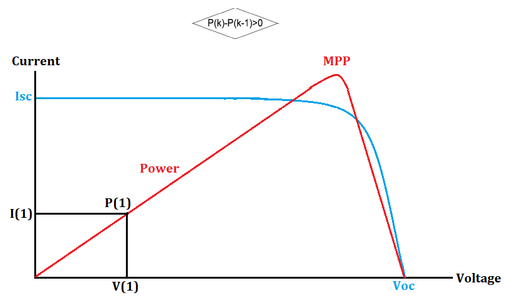

Before we discuss that first, we have to learn about the solar panel characteristic curve (graph 1).
This type of graph is called the I-V curve. ‘Isc’ is short-circuit current and ‘Voc’ is open-circuit voltage. Usually, you can see them on the backward of the panels at standard test conditions. Open circuit voltage is the maximum voltage and short circuit current is the maximum current that a solar panel can reach. It depends on the heat and solar radiation but for now, we will discuss it later. If we add the power curve to this graph, it will look like (graph 2).
As you can see the power line starts from zero and before the peak it continues like a linear line. The reason is voltage is changed but current can not go further than Isc. That peak power is our maximum power point. That means we can not produce more power than the peak point.

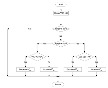

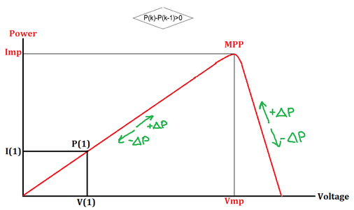

For this project, I chose the common and effective method called ‘Perturbation & Observation’ (Graph 3)
- How do this method work?

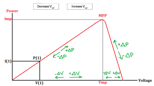

For clarity and a better understanding, we have to look at each part separately in this method
(Graph 4).

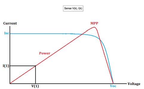

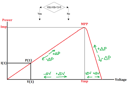

First, the algorithm reads the solar voltage and current value. Our first reading is shown as (1) second is (2) and it goes on like this. We assume that it is as shown in (Graph 4).
(Graph 5)
Next, the algorithm calculates the power shown as P(1). The initial value of voltage, current, and power assumed 0. It controls the difference between two power points. If there is no change between the two’s, it just returns the start position. In reality, we need to discuss this condition too but to understand the general idea, we can ignore this. If there is any change between those, the algorithm can skip to the next condition.
(Graph 6)
The algorithm has to compare if P(1) is bigger than P(0) because the algorithm has to know the exact point.
(Graph 7)
As you can see, the difference between power can be in LHS or RHS and move upwards or downwards. If the difference is bigger than 0, the algorithm knows it goes upwards, If not, it goes downwards. However, it still can’t find the side, so it has to look for the movement of voltage. In our case, P(1) is bigger than P(0).
(Graph 8)
The algorithm compares the voltage differences and decides the direction of the motion which is LHS or RHS. In our case, V(1) is bigger than V(0).
(Graph 9)
After the algorithm decides on motion direction, it increases or decreases the reference voltage. The reference voltage is actually the solar voltage value. If we decide to increase reference voltage, that means, we have to increase the solar voltage. After increasing the solar voltage, the algorithm starts to check where motion is again until it finds the MPP. For better understanding, we need to discuss what the duty cycle is and what a ‘buck converter’ is, we will talk about them in STEP 3.

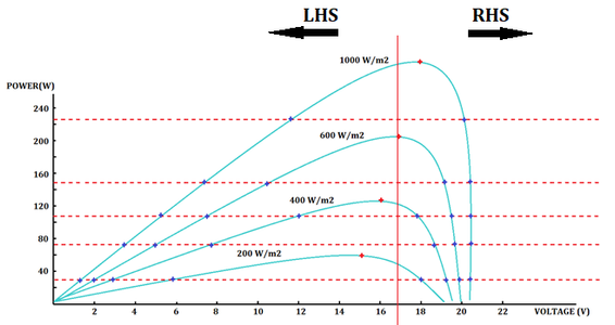

This graph shows power-voltage curves with respect to different solar radiations. Red dots are the MPPs. As you can see, solar radiation can change the maximum power point and open-circuit voltage. That means power can remain the same although MPP is changed.
(Graph 11)
Blue dots show equal values of power curves. As you can see, solar radiation can change but power can stay the same.

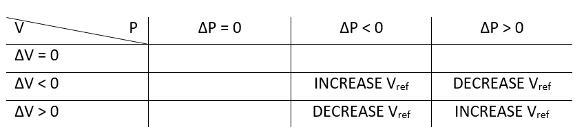

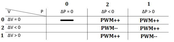

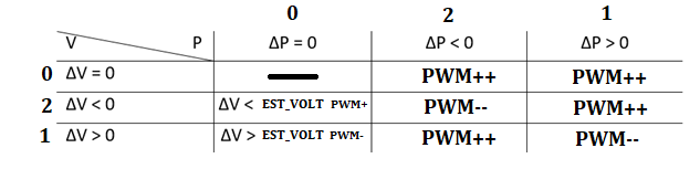

- Overall Table
(Graph 12)

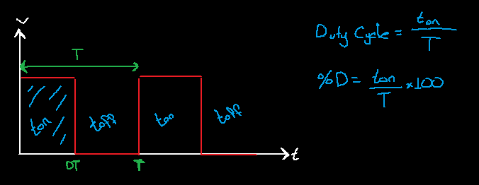

3. DUTY CYCLE
The fourth one is for this. The duty cycle can be calculated with the ON time divided by the period. In this way, we can adjust the voltage level with alter the duty cycle as I explained above.

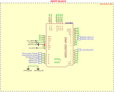

4. MPPT BLOCK
Pin 11 is a PWM pin and PWM frequency can increase 31kHZ.
IMPORTANT: You don’t have to connect pull-up resistors for all the I2C IC. Just one pull-up is enough for one bus.

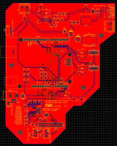

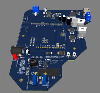

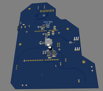

Step 6: PCB

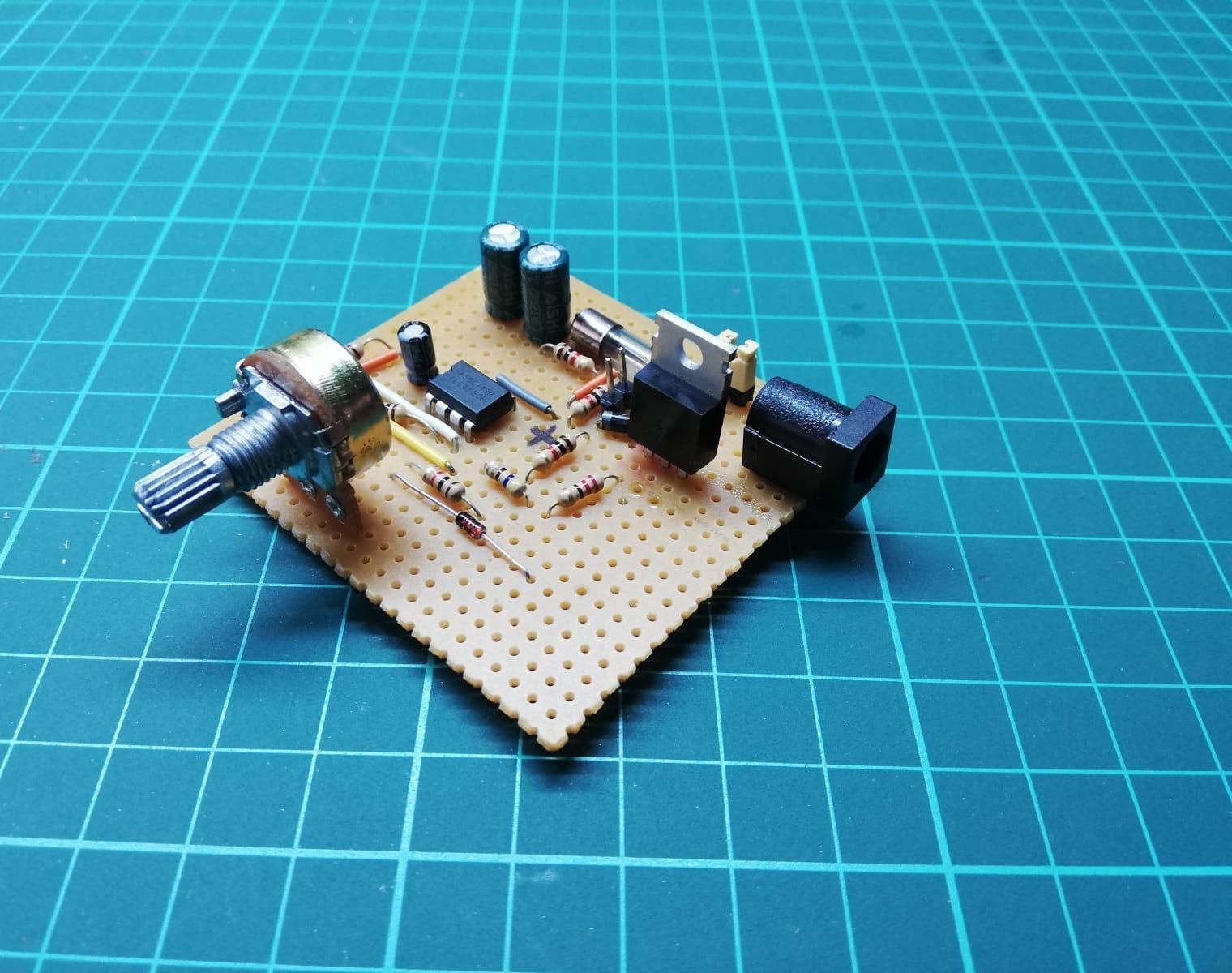

I designed the PCB using EasyEDA and ordered it from JLCPCB. the EasyEDA is easy to use and if you want to order the PCB, you can
directly order it from EasyEDA. I used the default settings for order parameters.
I used both sides of the PCB. The board is quite huge. The reason I soldered with solder-station is that I wanted to give myself some space.
Also, I wanted to connect Arduino to the board with headers and it took some space.
I changed that awful-looking electrolytic capacitor (6th picture) with an SMD capacitor. If you want to use both sides of the circuit board, you shouldn’t put electrolytic caps under it. It can not stay still on the table.

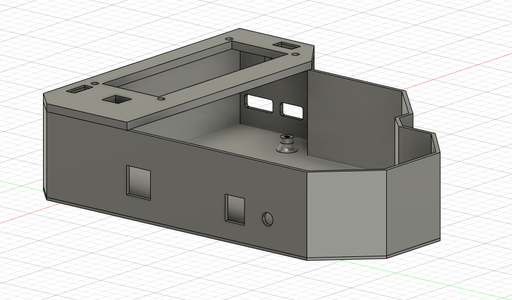

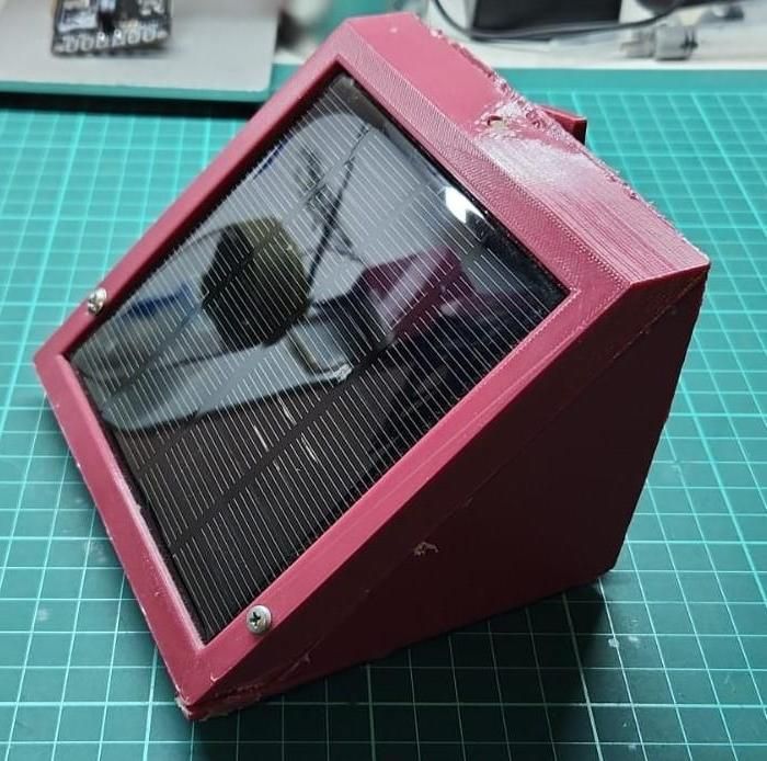

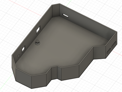

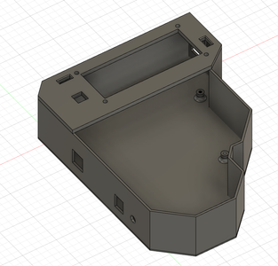

Step 8: BOX DESIGN
I designed a simple box for the circuit board by using Fusion 360. I will share the STL file with you too.
