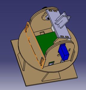

Step 3: Design and Cut Out the Solar Tracker
The different parts of the tracker must fit together perfectly. Therefore, the lengths must be considered in the light of the previous parts.
The 3D design of the pieces has been done using the Catia V5 software.
The cut of all the pieces can be made thanks to a laser cutter.
You have to calculate the tolerance so as to the final pieces fit and hold together.

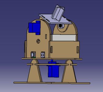

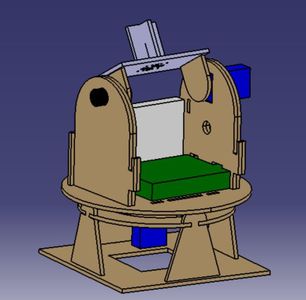

Step 4: Assemble the Pieces Together
After cutting the pieces, assemble them together.
There are 3 layers for you to gradually build. You can follow the pictures in order to assembly each layer's pieces. Then, assemble the layers together.

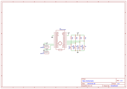

Step 5: Electrical Assembly
Connect the components together as showed in the electrical circuit diagram drawn by GreatScott.
Each of the LDR captor are connected to a resistance. LDR captor and Servomotors are all powered by the 5V outpud of the Arduino,as you can see in the picture. The blue and red wires of the picture are therefore connected to the four LDR captors.
To finish, you can put the Arduino card inside the device.
