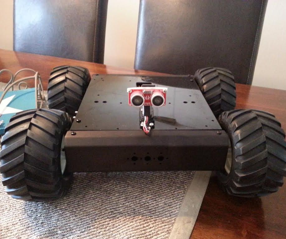

Introduction: Arduino Sonar Object Counter
This tutorial will teach you how to use a sonar distance sensor as an object counter. It uses the HC-SR04
