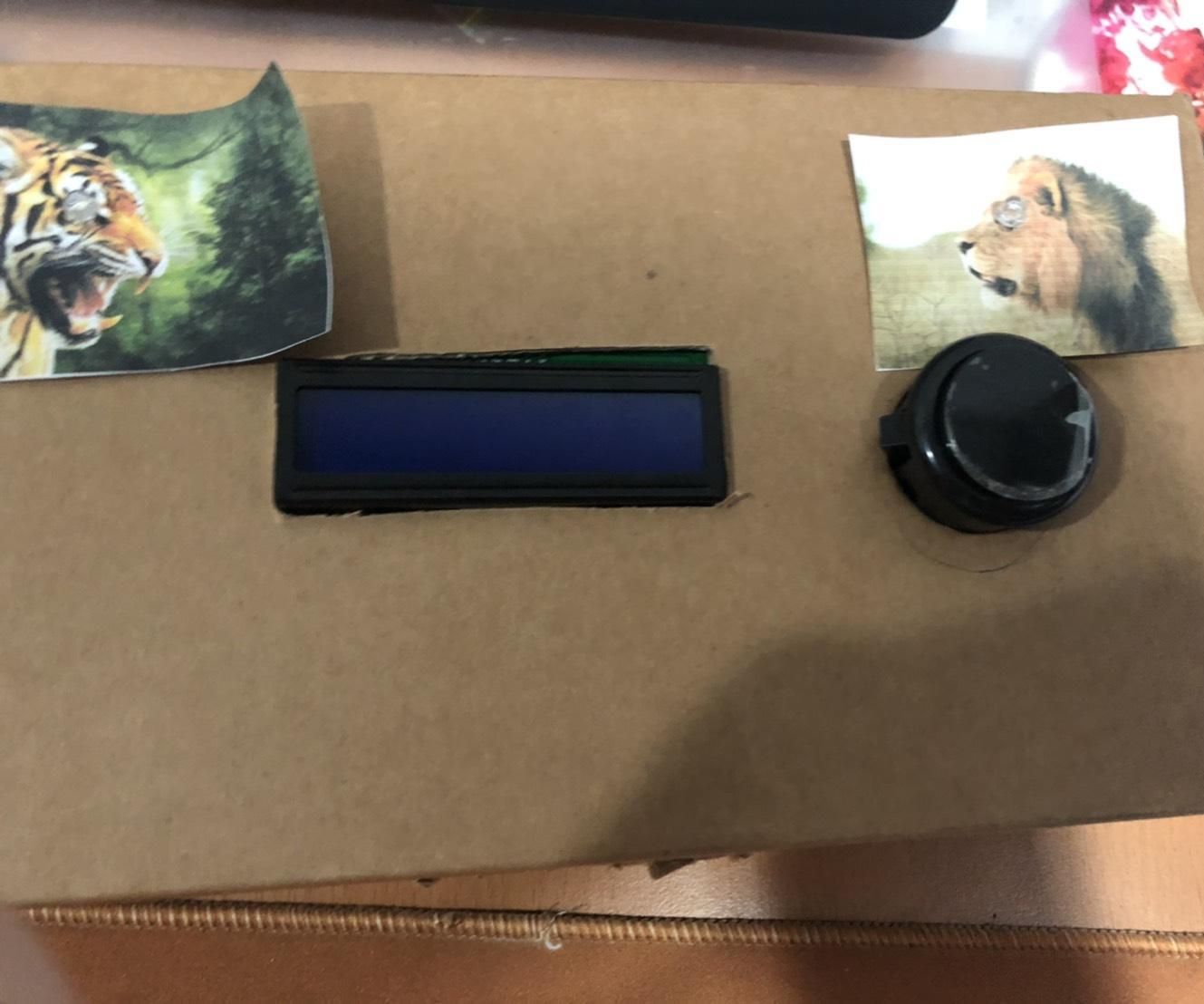

Step 5: Decorate Your Machine
Cut a cardboard box and make it into a cover for the machine, remember to cut a hole for the ultrasonic sensor to work, and also save a spot for the LCD board to show without needing the user to open the cover.
Step 6: You're Done! Enjoy Your Machine!
