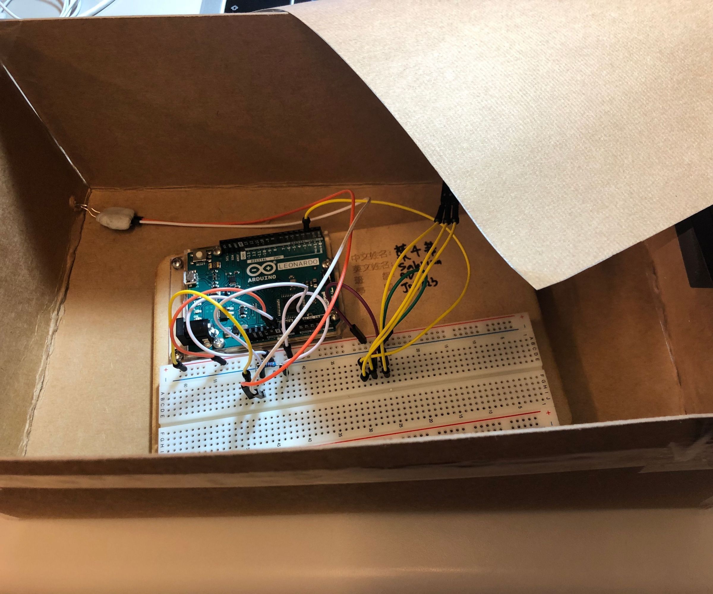

Step 2: Connecting the Buttons
First, you can see each button has 3 pins. The one on the left side of each button (you can swap them as well) connects to 5V (positive). The pin in the middle connects to the ground of the Arduino (through the breadboard) with a 10k resistor. The one on the right side connects the same row to digital pin 2, 3, 4, or 5 of the Arduino (can be configured in the code). You can use the above picture for reference.
Step 3: Connecting the Buzzer
You can see a + symbol on the top of the buzzer. It indicates the positive side of it. You need to connect the positive side to end to ground and this one to digital pin 8 of the Arduino (can be changed later). Then connect the opposite side to negative. You can use the above picture for reference.
