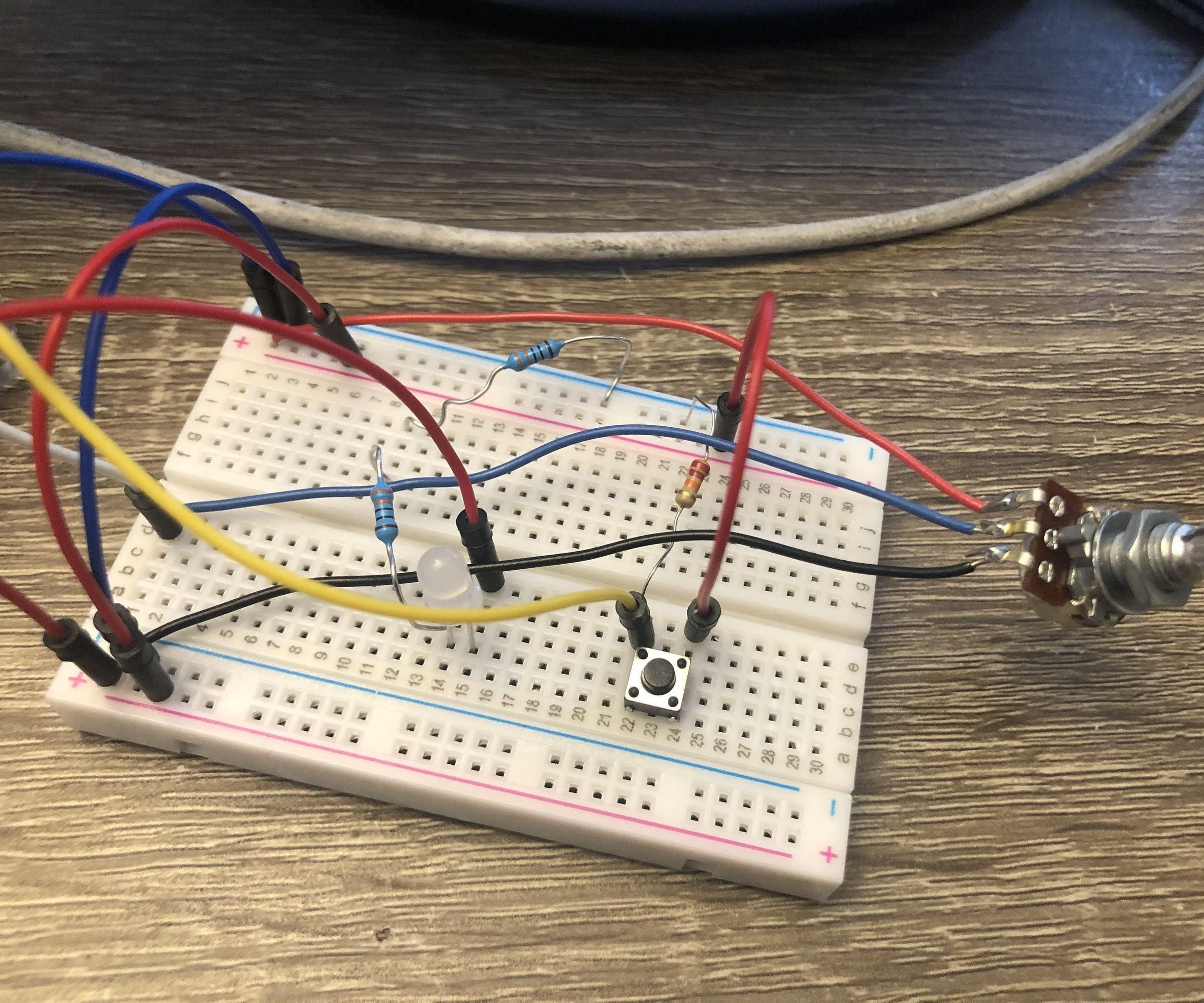

Step 1: Step 1: Schematic
Step 2: Hardware 1:
Connect the ground and 5v on the breadboard to the Arduino.
Step 3: Hardware 2:
Add 5 buttons to the board.
Connect Them to the 5v power and ground them with resistors.
Parallel them with digital input on the Arduino (using the port without PWM).
I'm using the port 2,4, 7, 12, 13 for the button 1,2,3,4,5.
Step 4: Hardware 3:
Connect buzzer to the board.
VCC to v5, GND to ground, and I/O to the PWM output on the Arduino.
I'm using 3~, 5~, 6~, 9~ on the Arduino for the buzzer 1,2,3,4.
Step 5: Hardware 4:
Add switch to the breadboard.
Power the middle needle with 5v and ground the left needle with a resistor.
Parallel the resistor with input on Arduino.
I'm using port 8 on the Arduino for the switch.
Step 6: Hardware 5:
Add two LEDs to the breadboard.
Ground them with a resistor.
Connect them with outputs on the Arduino.
I'm using ports 10 and 11 for LEDs 1 and 2.
