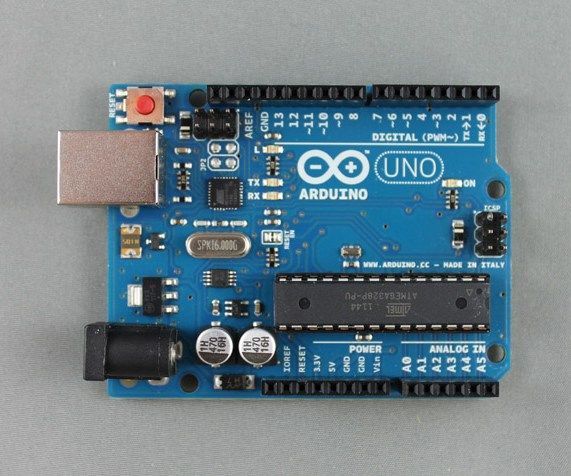

You will need the following electronic components to complete this tutorial.
- Arduino
- LED
- 220 Ohm resistor
- Jumper wires
- Breadboard
- A to B USB cable
You can find all the above things you need from Marginally Clever Arduino Starter Kit
