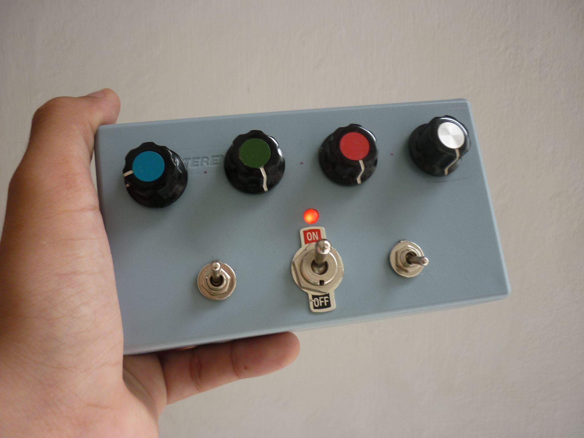

Step 4: Enclosure
Making holes is very simple but sometimes can be very tedious, especially when theres many holes. I took out a ruler a divided the box into 8, so I could drill 8 holes. After that, above I drilled two holes for the pause switch and the LED. Above 4 Holes for the pots. On the side a hole for the output and beneath a square for the Arduino usb port, so you can feed power through it. After putting everything in there place I slided in some Knobs on the pots and screwed ever component to the plastic box.
To making holes; try all type of drill bits to see what fits better for each component.
Step 5: Wrapping Up
So it's a fun piece of machine, and I wanted to share this nice build so later you can modify it and eventually make something even better. A few ideas on improvement would be; having a led for each step, that you could hold a tone to change it's frequency, have an input so you can send synth based sounds into this little machine, and finally add a MIDI output for using with the computer.
For know, Im going to use some sound effect boxes, which have input and output, so I can listen to the kind off sound generated with the steps.
